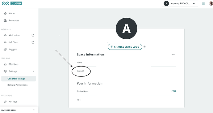

hi @aqbot1 ,
Be sure to:
  • create the API key from within the PRO Space
when you call the API, you have to include the
X-Organization value , otherwise, if left blank, the API will override the value with your private account.
You can find this string in your space home under Settings - > General settings - > Space ID
Thanks a Lot. It helped :blush:
