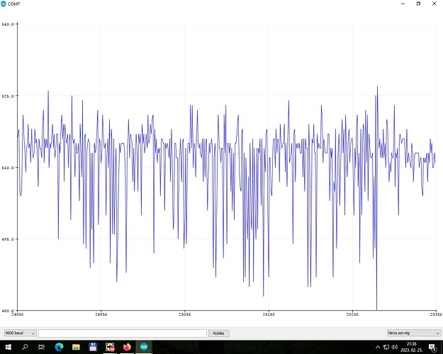

Hi !
I'm experimenting with the ZMCT103C and I'm also facing the drifting problem. I checked the circuit diagram and realized that it could be caused by the charging of the output capacitor. By bypassing it, the problem was solved, but even then, the output is not consistently around 512, but according to the serial plotter, it has many spikes between 490 and 520. I'm currently looking for a solution to this and would appreciate any help. Thanks.
Jozs

Thank you for your response! If the center significantly deviates from the 2.5 Volt midpoint in any direction, is it possible for the minimum or maximum of the sinusoidal signal to "hit" the 0 or 5 Volt limit, causing measurement errors?
But my real problem is not this, as I mentioned above, it has been solved. My issue is that there is too much noise on the output, and I don't know how to eliminate it.
Asymetric clipping can occur if the midpoint drifts too much.
But that midpoint is set by the hall sensor's internals, and should be fairly stable.
The rest of the parts on that board is for the digital output, with threshold set by the pot.
Hall sensors are noisy.
You can try smoothing code (averaging many samples).
Or move to a current transformer.
Leo..
Thank you, but as far as I know the ZMCT103C modul is a current transformer and has no digital output.
Oops, you're right.
And it has a blocking capacitor, which makes the output swing around 0volt.
And it has an LM358, which will clip asymetrically.
Maybe best to leave the module as is (with the blocking cap),
and add a 100k:100k voltage divider to the Arduino pin, to center the pin at VCC/2.
Then use the peak to peak detector code I posted.
Leo..
How are the pins labeled (may be on bottom of board)?
Pins are: VCC, OUT, GND, GND.
Have you tried a "smoothing" algorithm? Can you post your code?
I would like the circuit to function properly, as I am afraid I may face various errors later otherwise. In its default state, the output of the ZMCT103C should be 2.5V voltage, that is, it should be around 512 (~510...515), stable and without spikes. Currently, I am getting the result shown in the image when I read the analog input port on the serial plotter.
