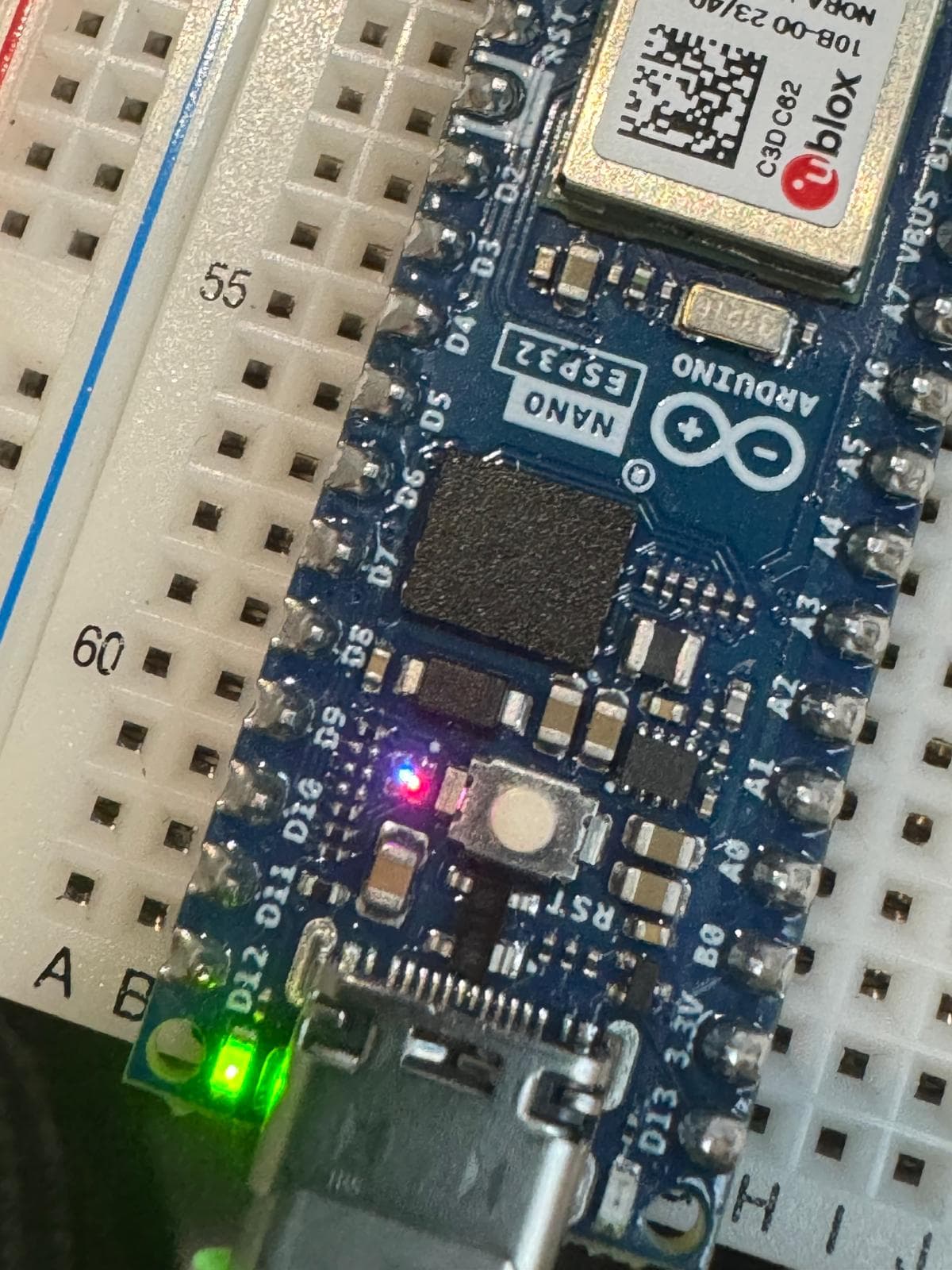

I have a Ardino esp32 nano. I have tried updating drivers but still give the error. There is blue red light which stays always on. Windows says you have the best drivers intsalled. First day it worked fine. Second day it has problem in uploading through COM, it was giving dfu error. I tried every thing firmware update. Can you please help me I have a project to do.

Hi, I have tried the solution. the problem is that it is not connecting to computer and I am getting the error USB device not recognized. The red-blue light stays on. When I press rst button, it goes off and again comeback. The green light never come. Thank you for your fast response.

The issue I am facing is that my computer does not recognize the esp32 nano. It says that the device has malfunction so that's why I cannot reset the device as I dont have access to it even if i am connecting B1 and GND with a jumper cable the light changed to green. but still get the same error. The main issue is getting a connection between esp32 to a computer. Here you can see I dont see any ports in port.
Try connecting the board to your computer with a different USB cable. It might be that the problem is caused by a damaged or defective cable.
