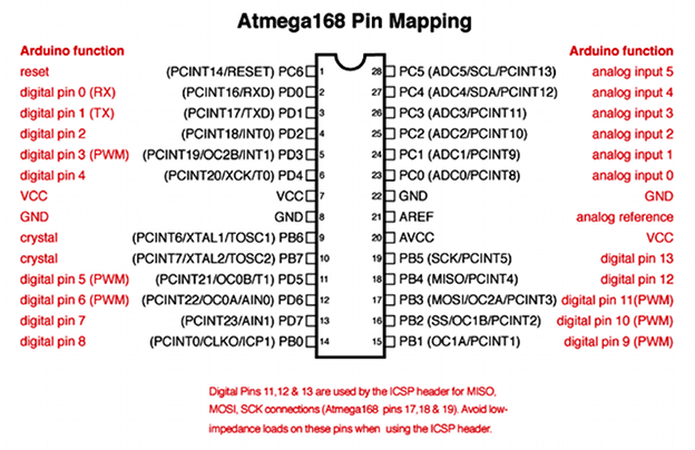

Regardless of the above i find that in most cases code optimization works best if done by hand. For example, instead of writing
digitalWrite (x, state); you could use as below:
//digitalWrite (6, LOW)
PORTD &= ~_BV(6);                   //Turn pin 6 low
or
//digitalWrite (6, HIGH)
PORTD |= _BV(6);                   //Turn pin 6 high
I use the attached image as reference. its for the 168, but same for the 328.
You can save a few bites by using direct port access. This is particularly valid when defining several inputs and outputs and also makes your code significantly faster.
Some libraries have better alternatives, that use less space. “tone”, and “lcd” are just some examples.
