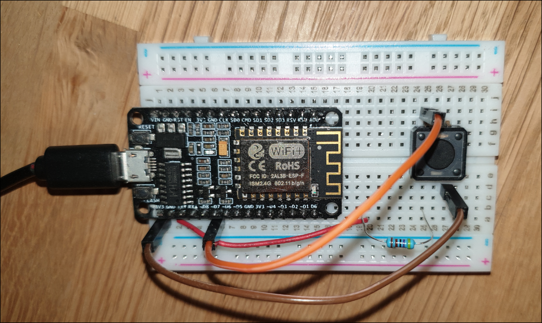

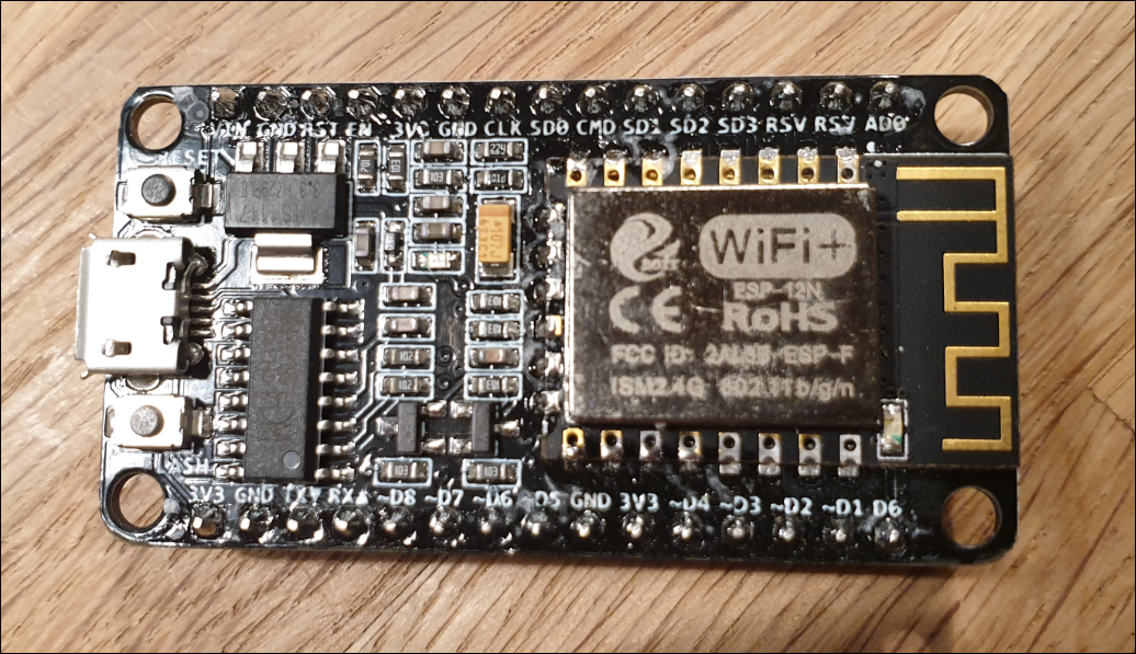

I have a running board of the same model. If i connectet to USB - nothing happend, but if i push a bottom, then it sendt a "Push bottom" MQTT signal tom my broker. It works. I have programmed the board with Arduino IDE at the same PC for months ago.
So it is not a dead board.
Here is some pictures of the board, and the running board.
That the seemingly not working one is still capable of sending from MQTT.

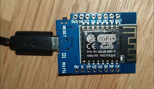

I have tried to connect a Wemos D1 Mini, which has also worked before, but with the same result, no port asignment.
Wemos D1 Mini

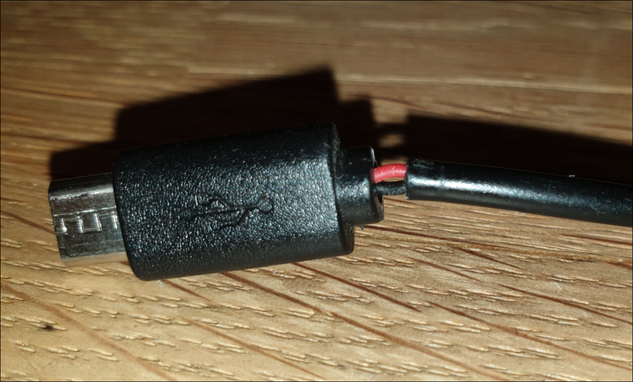

Is that outer sheath where the enters the connector cracked or peeling as there is a spot of red in the picture.
Maybe the cable has an intermittent fault ?

Hello Bob
A really stupid mistake on my part. Well, I hadn't noticed.
The cable is not at all a real USB cable it turns out. :confused:
There are only 2 wires in the cable, only at power cable - probably intended to charge something. Never seen it before, and don't know where I got it from.

Sorry it took us both a long time to get there but glad you seem to have the answer LOL
Many mico cables are power only and they need to be power and sync/data.
They also go bad very easily.
