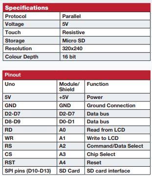

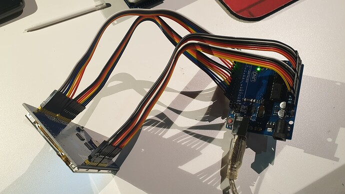

I also have the 2.8" TFT LCD display:
https://www.jaycar.com.au/medias/sys_master/images/images/9594875478046/XC4630-dataSheetMain.pdf
Here's the 2.8" LCD connected to the Uno.
As I am writing, I thought to myself that I need more pins, if I use this setup.
XC4630
I can unplug D10-D13 as I don't need the SD card feature.
I'll just use the Mega board with the 2.8" screen as it has more pins.
I don't know what extra pins you require for your Uni assignment.
The Uno Shield will plug into the Mega2560 and work 100%. (but slower than a Uno)
The Uno Shield will plug into the Due and work 100%. (but slightly faster than a Uno)
You can access the 2x18 header with the shield in place.
