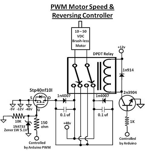

Hello Everyone,
I ran my PMW circuit on the welding positioner yesterday and the motor was humming as well the same way it did on the spare motor. The humming is loud but it’s not too loud as the noise coming from the gear reduction, sprockets and chain mask the humming sound but at the very low rpm it is quite noticeable. The motor is a 10 to 50 volt dc brushless motor.
I have a few questions for anyone here that is reading this and cares to comment.
First off does anyone know what could be causing the humming of my motors?
Secondly, Id like to add an optoisolator to my PWM Motor Speed Controller schematics which is included below. MarkT recommended using a gate drive optoisolator and I managed to source one, part #IX3180 but I’m not sure if this one is best suited for my application. Can anyone recommend an optoisolator that stands a good chance of working in my circuit schematics?

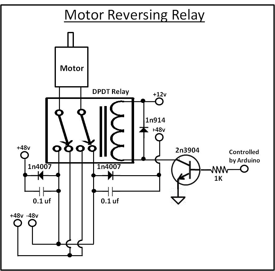

Also I’d like to add reversing capabilities to the motor speed control. I did a schematics (the schematics is included below called “Motor Reversing Relay”) using a relay to reverse the motor and I included snubber diodes and caps in the schematics to protect the arduino board. I’m not sure if I have the snubbers wired correctly but it makes sense to me. Does anyone have any comments on this circuit, good or bad?
I’d like to add a normally open momentary push button to reverse the motor and at the same time it would light an led (1 of 2 led’s) to have a visual indication of the motor rotation, one led for clockwise and another led for anti-clockwise rotation. I was thinking I would write code to shut off the motor first before allowing the switching of the rotation. I’ll include the code when I get that portion done.
I’m hoping that someone here is in a position to help…
Thanks In Advance
jessey
Ok,
I tried the relay and it works good by itself to switch the rotation of the motor, I tried it without the snubber diodes and capacitors. I put together another schematics that ties the speed control and the rotation switching schematics together. I think I got it right. I’ll be trying this circuit I uploaded in a few days when I get the time. Can someone (hopefully) have a look at this schematics to see that I doted all the i’s and crossed the T’s or if I missed anything? It would be very much appreciated…
Thanks In Advance
jessey
Humming is the PWM. What PWM frequency are you using? Do you want it to be ultrasonic
so its inadible?
Hi MarkT,
Thanks for getting back to me. The frequency I’m using on pin 9 of my ATmega2560 is the default frequency which is 490 Hz. I did some searching and found this thread which sounds good if I am understanding it correctly.
This URL is where I found the information below: http://forum.arduino.cc/index.php?topic=72092.0
According to what I read the PWM default frequency for the ATmega2560 is 490 Hz for all pins, with the exception of pins 13 and 4 which is 980 Hz.
According to valerio_sperati, I can change the prescaller for pins 10 and 9 to change to the different frequencies that are available. First I have to clear the 3 bits in the prescaller using:
int myEraser = 7;
TCCR2B &= ~myEraser;
now that the prescaller is cleared I can include these two lines of code below to write a new value:
int myPrescaler = 3; // 3 = 490 Hz (default value)
TCCR2B |= myPrescaler;
changing myPrescaler value above from 1 to 6 will change the frequencies to the ones listed below:
prescaler = 1 —> PWM frequency is 31000 Hz
prescaler = 2 —> PWM frequency is 4000 Hz
prescaler = 3 —> PWM frequency is 490 Hz (default value)
prescaler = 4 —> PWM frequency is 120 Hz
prescaler = 5 —> PWM frequency is 30 Hz
prescaler = 6 —> PWM frequency is <20 Hz
So am I correct in thinking that all I have to do is put these 4 lines of code above into the void setup() portion of my sketch and set to whatever frequency I want to try? I’m at home today but will be going to the shop tomorrow to try this new code. I should try it as you suggested at 31000 Hz which would be an ultrasonic frequency and above the frequency humans hear at and hopefully that’ll fix my noise problem. Any insights you have on this subject will be very appreciated especially to hear that I got the code deciphered right.
Also could you have a quick look at the schematics I just uploaded here to see what you think. If you have the time I’d really appreciate it if you could advise me of what optoisolator you would consider to be compatible to isolate the mosfet in the schematics? You had advised me in a previous post that I quoted below:

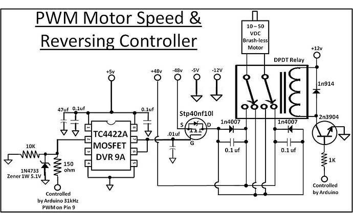

You might find that your MOSFET will get hot if you if you increase the frequency to 31kHz.
When a MOSFET is turned hard on, it doesn't dissipate much power. (low voltage x high current). When it is off, it doesn't dissipate much power either. (high voltage x low current).
However as the MOSFET switches between these two states, it goes through a high power state. (high voltage x high current).
Increasing the frequency causes the MOSFET the heat up more as it spends more time in this high dissipation state, hence the average dissipation increases.
You can overcome this by using a MOSFET driver such as Microchip's TC4422A. (Datasheet here.)
There is lots of useful information in this application note.
Thanks JohnLincoln,
I really appreciate your help with this. I re-did my schematics again to show the mosfet driver wiring I added. I wasn’t sure how to properly wire in the mosfet driver IC but I took a stab at it anyway using the data sheet schematics as a reference. If you could have a look to see what has to be changed in my schematics it would be very much appreciated.
Do you think I should have an optoisolator to feed the 2n3904 transistor as well? I couldn’t find a 5 volt relay with a suitable amp rating but I did have a couple of 12 volt ones with hefty points laying around so I used one.
