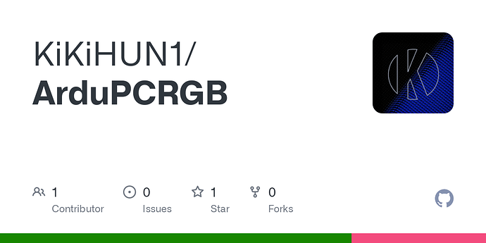

I learnt php, c#, html, js, java for 5 years in my school. So i can call it medium-high level.
Now i started playing with arduinos.
I made a pc rgb controller with desktop app already.
