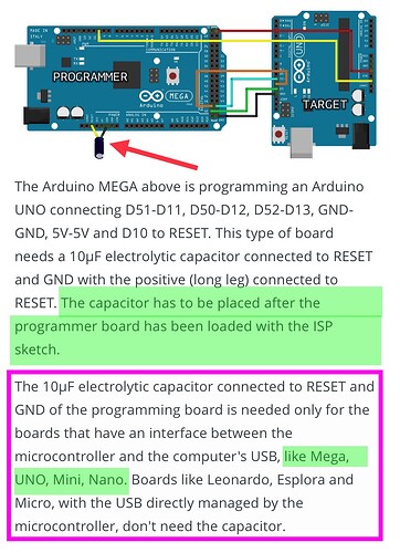

I've read a ton of tutorials about using one arduino to program another (arduino as isp) and I'm just not getting it working. Here is what I have done, help me figure out why it doesn't work!
I have a working arduino w/bootloader and I have hooked it's ICSP header pins directly to a second working arduino w/bootloader (both arduinos can be programmed over usb, just fine in arduino ide).
  • I have loaded the arduino that's connected via USB with the ArduinoISP sketch.
  • I opened blink as the sketch I wanted to burn to the second arduino.
  • I selected Arduino Uno R3 as the target, /dev/ttyACM0 as the port, and Arduino as ISP as the programmer.
  • I selected sketch->upload using programmer.

  • I use this:
Are you saying you have connected the two ICSP headers together? If so, that's incorrect. Pin 10 (IIRC) on the programmer board needs to connect to /RESET on the ICSP header, not the programmer's /RESET signal.
OK. I connected pin 10 on the programmer to reset on the target. Same result.
I don't know about the capacitor. Where can I see a schematic or description. That sounds promising.
Yup. The capacitor was the solution and it was in the writeup I read to hook stuff up. I think it could be more clearly written though and a uno r3 to uno r3 diagram would be helpful. Off to capture my notes on this so I don't repeat hours and hours of frustration! Thanks LarryD!
