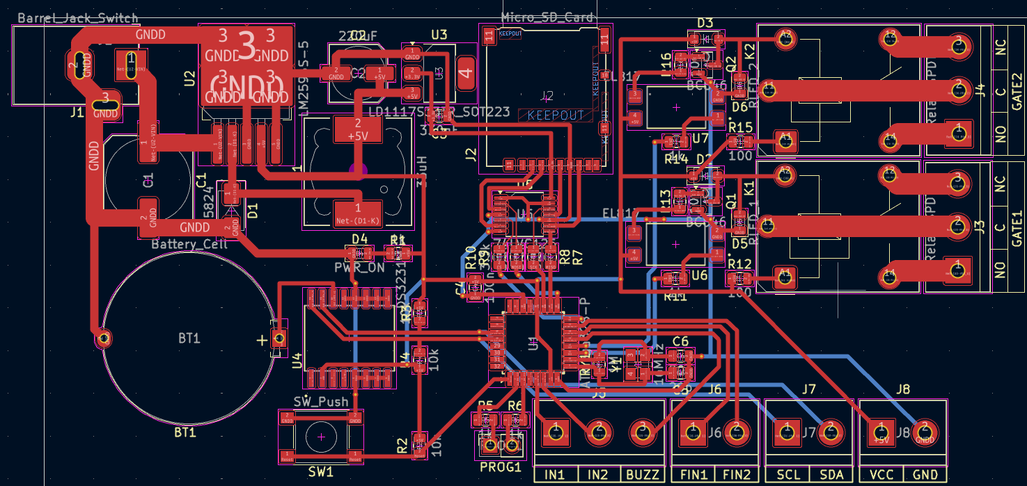

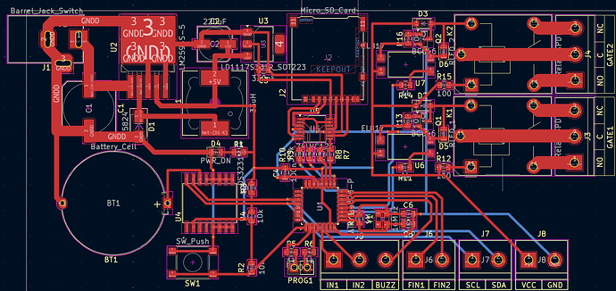

if we're talking about this chip on which i want to install bootloader it is on some kind of board with relayes, diodes etc (project made by me)
port and programmer are fine, i've checked port on device manager and i'm using this arduino as isp option with isp program loaded on uno. I will try with minicore tommorow and let you know if this helped.
I suspect that your custom design is bad.
I installed minicore and i'm still getting same error. You can see my settings below. I think they are okay.
It is possible but i dont know what can be wrong with my board
Could be a hundred different things but without seeing a schematic and PCB layout we can't help
Is it possible that your 328P is a fake one?
It doesn't seem this is right for Arduino as ISP.
There are 2 things that are different from layout:
  • i didn't checked oscillators pinout and had to "repair" it (oscillator is diagonal when you're looking on his pins and i have horizontal on layout),
  • i made a little change to part of circuit which turns on/off relays but i don't think it would interfere microcontrolers work (the change is not on schematic).
i don't think so because i bought it from TME (it is good source for me)
what do you mean by that?
I don't see an ICSP connector.
