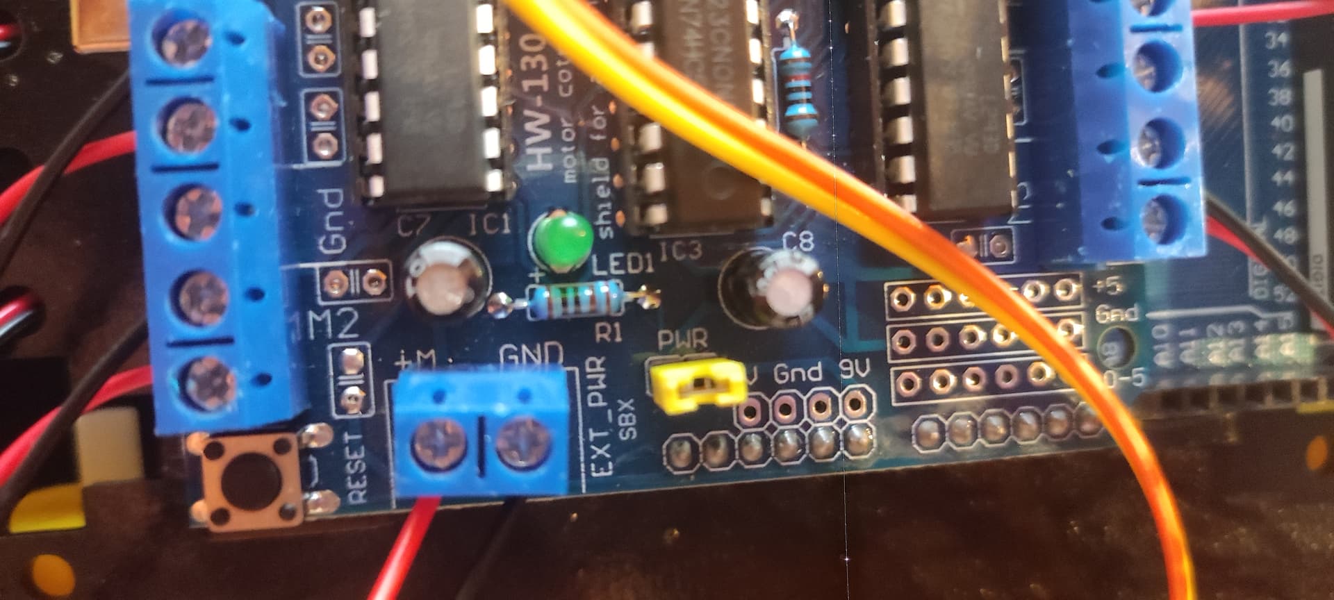

I have an arduino mega with an adafruit motor shield in order to control 4 DC Double Shaft Gearbox Motor, 1 LCD I2C, 4 LEDs, and to power all of this I'm using 4 1.5V batteries (AAA size in Spain). When I connect the arduino mega to my computer and I use the 4 batteries to power the "car" it works perfectly, but when I already upload my code to the arduino plate, I disconnect it from my computer to try it in the ground, but it works like this video when it should work how this video but with the PC disconnected. I'm using App Inventor to controll the car by sending some letters as code to do something like turn on the LEDS. I tried by putting some more energy by adding 2 batteries of 1.5V but it's happening the same. Thanks for your response. This is the code I'm using:

How is the controller powered here?
with 4 batteries of 1.5V each
Connected to what controller pin?
they are connected to M+ and GND from the Adafruit motor shield
What is that? Pen and paper would likely make it clear.
Know that Vin needs 7.5 to 12 volt to work. Connecting to the 5 volt pin will damage the controller.
It's connected to this two pins, GND, and +M, it's said in all the videos I saw about this shield
What is connected to this position? What pins of that device?
Please draw a schematic of how everything is connected
I checked the videos, your car is probably drawing more current then what the batteries can provide, try using rechargeable batteries, 4 nimh aa sized or 2 18650 batteries.
If you go with the 18650 remember that these have a nominal voltage of 3.7 volts so 2 batteries wil give 7.4 volts.
Make sure your electronics can handle this voltage and use a voltage regulator if necessary
