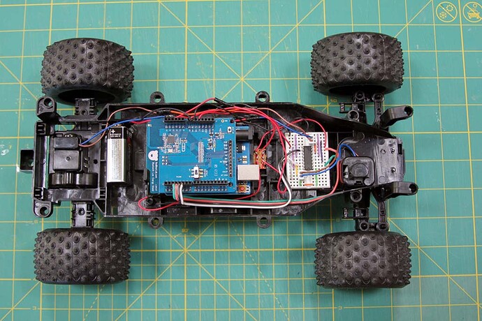

I have not had a chance yet to create a blog showing how to use the Redbear BLE Shield from an Arduino, but you can find the information in the book, Building iPhone and iPad Electronic Projects, from O'Reilly:
The book has a pretty fun project with the Arduino. You'll see how to hack a cheap radio control truck, improving it's performance and controlling it by tipping an iPhone. There are also lots of other projects, although many deal directly with BLE devices like thermometers, accelerometers and so forth; these don't use an Arduino.
