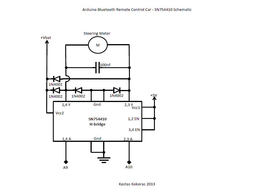

For the car i removed all the electronics exept the motors and i installed 6 new AA 1,2V rechargable NiMh 1900mAh batteries. I designed new electronics based on Arduino with a HC-05 Bluetooth module and two h-bridge ic's. The L293D for steering motor and the L298N for forward/backward motor. For both ic's i connected parallel the channels, 1 with 4 and 2 with 3.

I switched from L293D http://www.ti.com/lit/ds/symlink/l293d.pdf
to SN754410 http://www.ti.com/lit/ds/symlink/sn754410.pdf
cause it was getting a little hot.

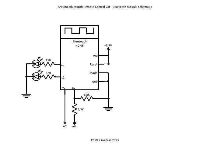

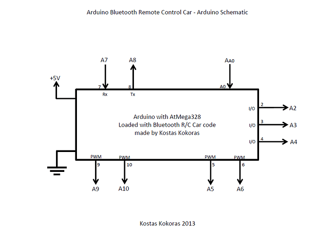

Here are the schematics

One comment, your pins are labeled A0 through A10, although you are using an Atmega328… Should those numbers be D0 through D10? The Uno board has A0 through A5 only.

Thank you for your nice words.
The AA0 and A2 through A10 labels it is not the pins of Arduino Uno. It is the labels that connect the rest of the schematics with the Arduino schematic. The actual pins of Arduino Uno is labels A0 and 2 through 10 where is by the lines starting from the rectangular that represents Arduino Uno. I hope this clears out the labeling. Sorry for not beeing so clear.
Thank you. I understand now!
