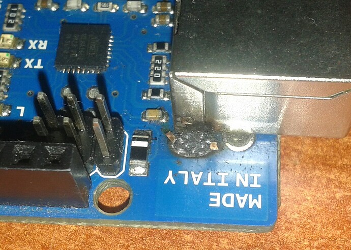

Hello guys, Ive recently noticed that the led thats labeled "L" (the one that you can control with pin 13) was dimmer than usual. I started to check the board visually because i dont have a multimeter and discovered a burn mark at the right side of the usb port (looking the board from the top), the traces are broken and there is no capacitor and no solder pads. I wanted to know if someone could tell me the value of this capacitor so i can buy a replacement and what could be the possible causes of this "explosion"? it is an arduino mega 2560 r3.

Looking at my UNO (SMD version actually) rather than the schematics, it has a relatively thick track and is presumably a Vcc bypass.
Either Vcc was applied in reverse, or the capacitor was placed backwards. If you can manage to solder a 10µF tantalum, either leaded or SMD into the position it should be OK.
Maybe it was just faulty.
Well, my device is around 1 year old by now so i dint think its a factory defect, i almost always use usb, i think that capacitor is connected to the shield of the usb port and the other end goes to the little ic, by the way thanks for the quick reply
