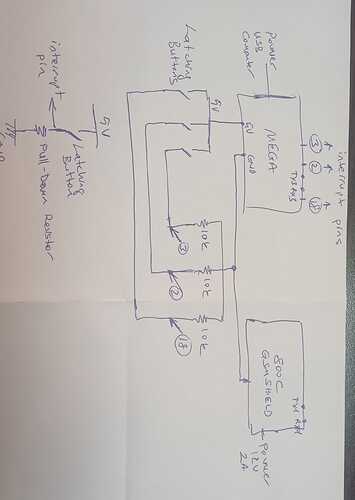

I am using mega with interrupt pins 2, 3 and 19.. The problem is when pin voltage (5V) change from 0 to 5V it triggered but when 5V to 0 sometimes it does not triggerred
I have tried debouncing as 5 to 1000microseconds but only 500microseconds is more stabil but it still cant catch the change sometimes... changing periods are not very short more than 3 seconds
I am using a latching button to change pin voltage

do you have external pull-up or pull-down resistors?
can you share the circuit you are using?
That defeats the use of interrupts, which you shouldn't use for human-operated buttons/switches anyway.
Leo..

I am using pull-down resistors as 10k.
If I try without interrupt in loop code run continuously and in setup part it runs only one time
I need to send fault information when it occured
The button represents voltage signal when fault detected..
loop() is supposed to run continuously. setup() is supposed to run one time. This does not indicate a problem. Please describe your problem more accurately.
If you test for the pin to be HIGH, why do you track changes, just track RISING and you’ll be sure the pin is HIGH in the ISR ? Why do you invert the flag? you should just set it.
In the loop you should use a critical section when you check and reset the flag.
Not sure you really need interrupts at all unless you don’t want to miss a flag that would be set whilst handling something else that is long
