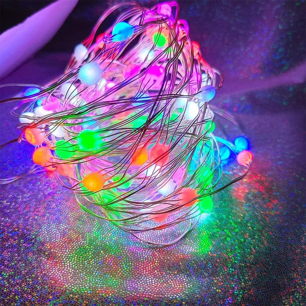

I also recommend WS2812B approach. But instead of led strips that are not really usable for christmas tree, look for WS2812B STRING. They have same individual control, but have a form of traditional xmas tree lights.
