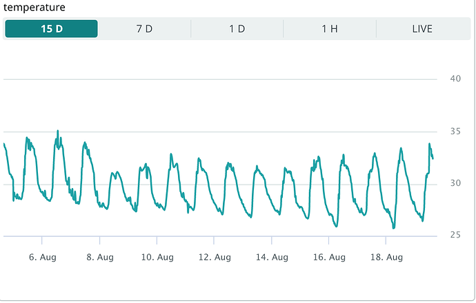

I am using the Arduino iot cloud to create a temperature graph. But the limit in the dashboard for graph is only 15 days. How can i make a graph for longer time?

I do have the "maker" plan but i dont have 90 days
Maybe try making a new graph - what plan did you have when you made the existing one?
I had the free plan, I tried making anew dashboard and a new chart, still 15 days
The chart widget's maximum time span is currently 15 days, independently of the subscription plan. We are working on improving the chart widget to allow a bigger time span.
