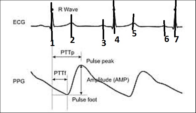

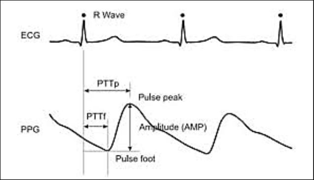

Hello everyone,Thanks for your suggestions. This project involves calculating Pulse Transit time from ECG and PPG. I've attached an image for your reference.
As some of you said,To detect peaks using slope calculation. But for an sine wave it works but for an ECG signal local maximums might be there. So it kind of becomes a problem.

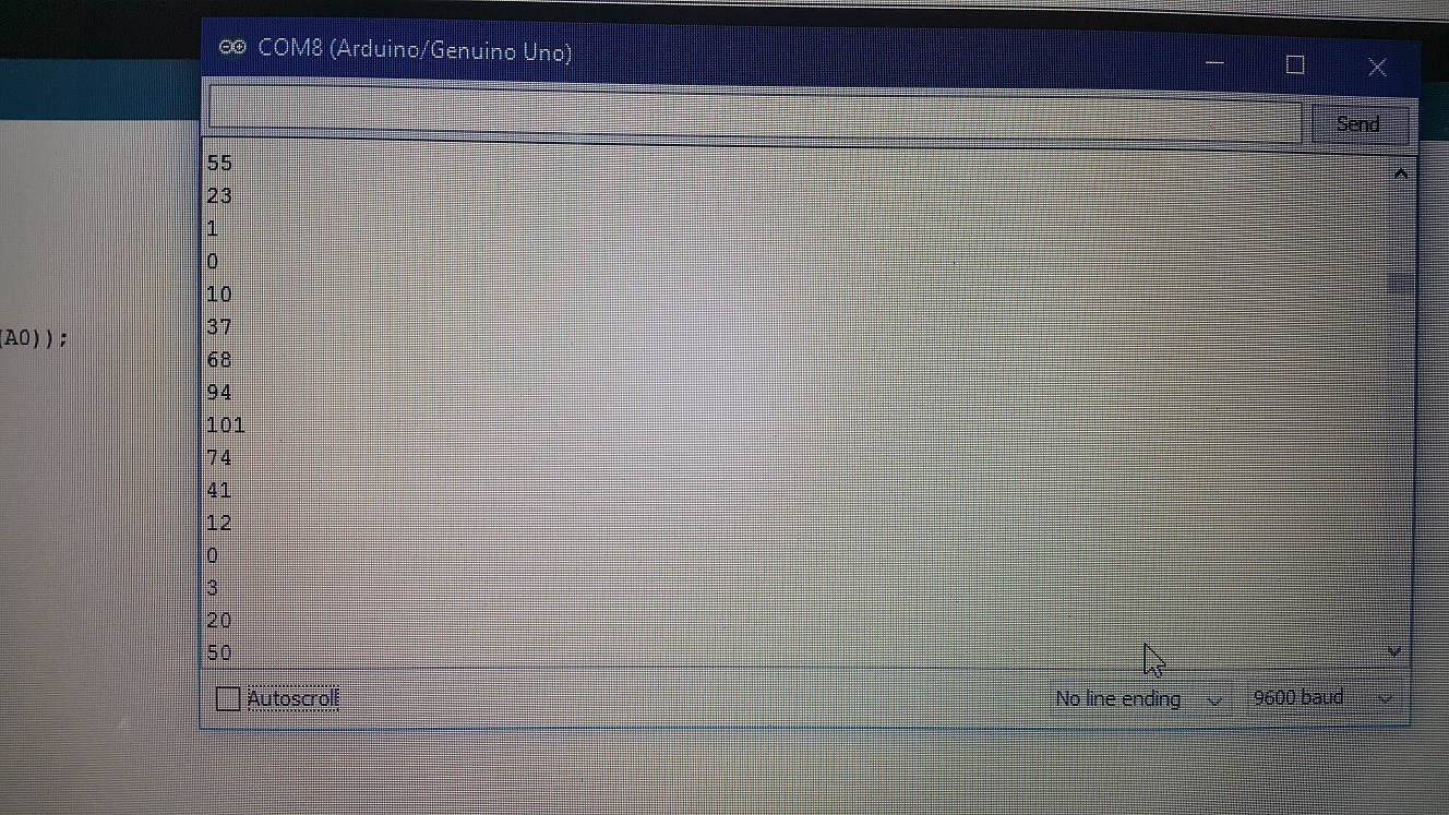

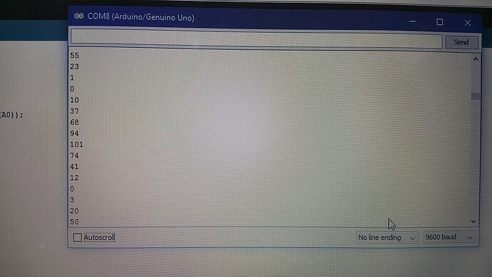

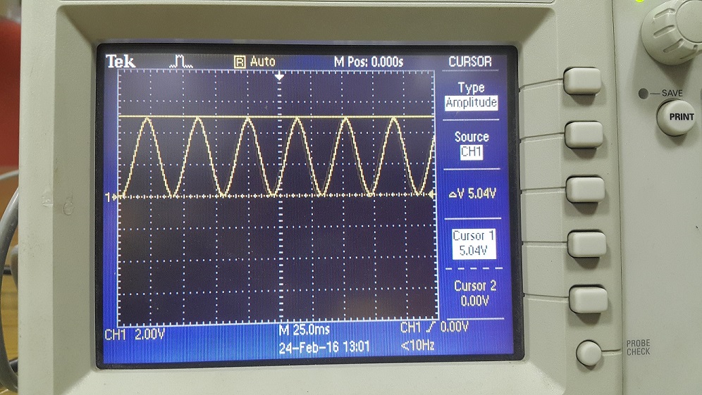

and some said to calculate interval between zero crossings i.e from 512 to 512. For that when a sine wave of 5V is given, serial monitor shows only values between 0 and 100. It has to show between 0 and 1023 right ? I've attached the code, Input signal and serial monitor output. Please check it out.

I think you have to be more precise about the "peaks".
I have taken one of your pictures PTT.jpg and edited it a little bit: I included all the peaks I could see in the curve and numbered the peaks 1, 2, 3, 4, 5, 6, 7.
Here is the edited picture with some peak numbering.
I think there is also two different types of signals presented in that picture: "ECG and PPG
You want evaluations about two different curves, which are measured in parallel?
So if you want to get results for the time from peak to peak, you possibly will have to tell about the time between which peaks you mean.
Peak-1 and Peak-2?
Peak-2 and `Peak-3?
Peak-3 and Peak-4?
Peak-4 and Peak-5?
Peak-5 and Peak--6?
Peak-6 and Peak-7?
Or maybe peak-1 and peak-4?
Or peak-4 and peak-7?
Or maybe times from two different curves taken, such like starting time is peak-1 from curve ECG, and you want to have the time until in the second curve PPG the point marked "Pulse Peak" has come?
There is a lot of local "peaks" in your two signals, and you clearly will have to define what you want. If you are unable to describe it precisely, nobody will be able to find it.
The more complicated it gets, and the more different curves with a lot of peaks you have and want to combine, the more complicated the evaluation will become.
Your signal looks quite clean, repetitive and has adequate amplitude for detection. If you're only interested in measuring the time interval between each cycle, then the time interval at the "zero" crossing (mid-point) would be the same as the time interval between peak-peak.
Using the analog input will limit how accurate your measurements be as you may only achieve millisecond resolution as you would be polling to get readings. Much better timing resolution could be had by an external op-amp/comparator circuit and using a digital interrupt. Also, Arduino's built in comparator is very fast and can provide an interrupt for accurate time measurements.
For testing, here's a circuit that would capacitive couple your signal to 2.5V (ADC value of 512). Could use lower tolerance resistors 1% or 5% knowing how much this could effect the midpoint voltage. Then you could choose a detection level in software like this:
  val = analogRead(A0);
  if (val > 550 && previousVal <= 550) {
    // impulse detected ... record time micros()

This would have been very good info to have in the first post, instead of just saying "like a sine wave". If you aren't interested in measuring a sine wave, don't ask about one.
As was pointed out by a few people here, "peak" for a complex periodic signal is ambiguous. You need to be very clear about exactly what features you are looking to detect.
For the ECG, it's clear that what you're looking to detect is not all the local maxima, but the infrequent large spikes. For those, there are two salient features that can be detected: the slope and the amplitude.
One method (to detect the steep slope) is to differentiate the signal (calculus) and detect when the slope goes above a certain threshold value. Then you measure the time different between the slope threshold crossings.
A second method (to detect the large amplitude) is to use a low pass filter with a long time constant to track the average value of the wave, and set a threshold level a certain amount above the average. Use the transitions above that threshold to calculate the period between spikes.
