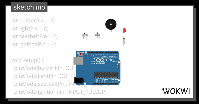

I have copied your sketch to Wokwi:
You make intensive use of delay()! That blocks your code too much! It cannot react on changes.
(As you may use an active buzzer and Wokwi provides only a passive one, it will not make sound ...)

Here is a way how it works:
constexpr int buzzerPin = 3;
constexpr int lightPin = 6;
constexpr int seatbeltPin = 2;
constexpr int ignitionPin = 4;
constexpr unsigned long waitBeforeAlarm = 2000;
unsigned long lastTimeBlinked = 0;
unsigned long alarmTime       = 0;
unsigned long blinkInterval  = 500;
boolean       alarmActive = false;
boolean       doAlarm     = false;
  pinMode(buzzerPin, OUTPUT);
  pinMode(lightPin, OUTPUT);
  pinMode(seatbeltPin, INPUT_PULLUP);
  pinMode(ignitionPin, INPUT_PULLUP);
  digitalWrite(buzzerPin, LOW);
  digitalWrite(lightPin, LOW);
  // Check if the seatbelt is fastened and ignition is off
  boolean giveAlarm = (digitalRead(seatbeltPin) == LOW && digitalRead(ignitionPin) == HIGH);
  if (!alarmActive && giveAlarm) {
    alarmActive = true;
    alarmTime = millis();
  if (alarmActive && !giveAlarm) {
    doAlarm = false;
  if (alarmActive && millis()-alarmTime > waitBeforeAlarm) {
      doAlarm = true;
  if (doAlarm) {
    if (millis() - lastTimeBlinked > blinkInterval){
      lastTimeBlinked = millis();
      int buzz   = !digitalRead(buzzerPin);
      int light  = !digitalRead(lightPin);
      digitalWrite(buzzerPin, buzz);
      digitalWrite(lightPin, light);
You can check it out on Wokwi:
The left slider is connected to the ignitionPin, the right one to seatbeltPin.

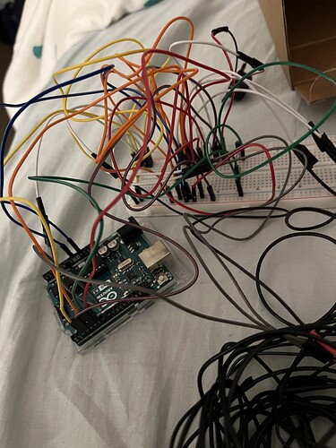

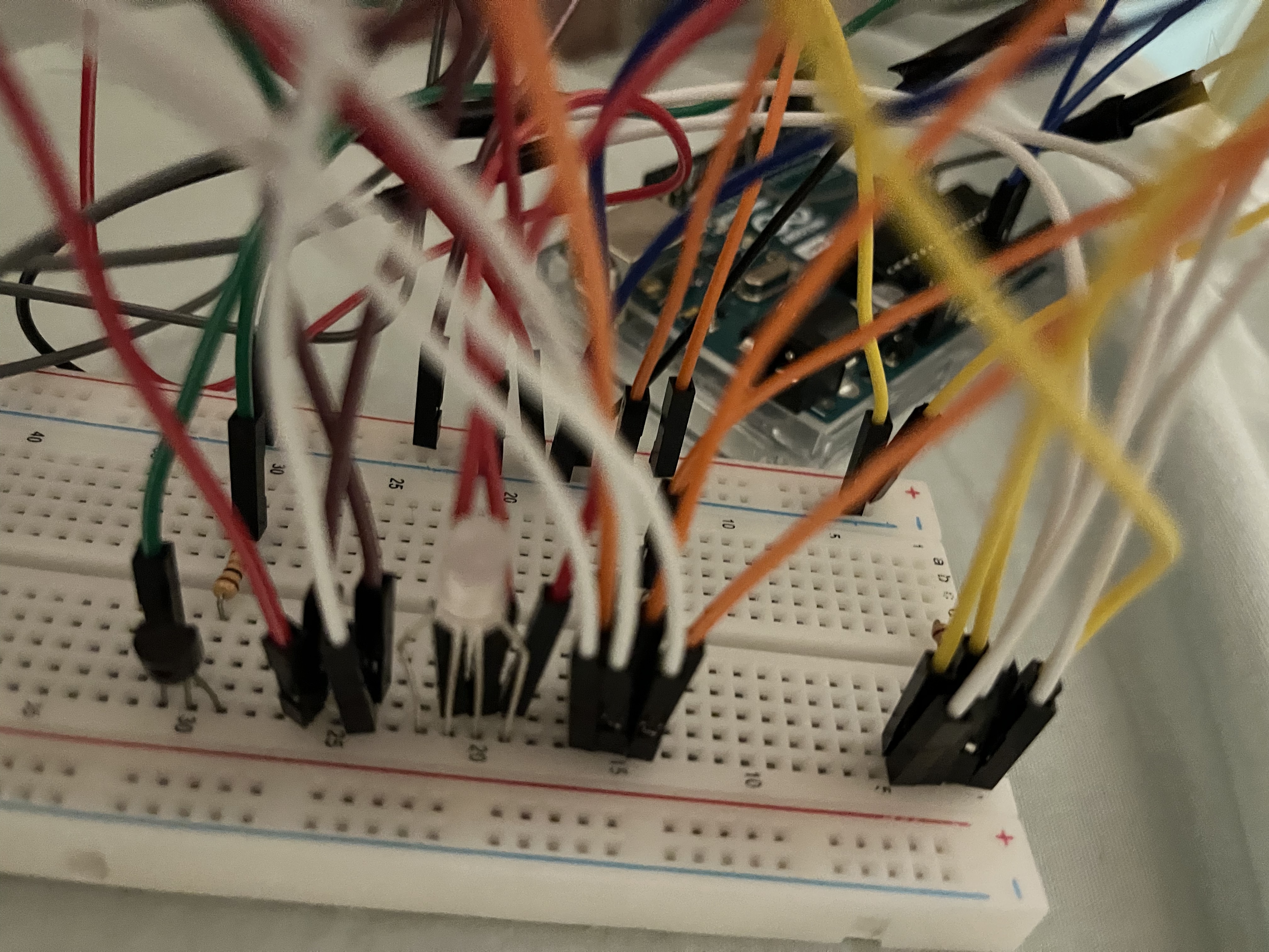

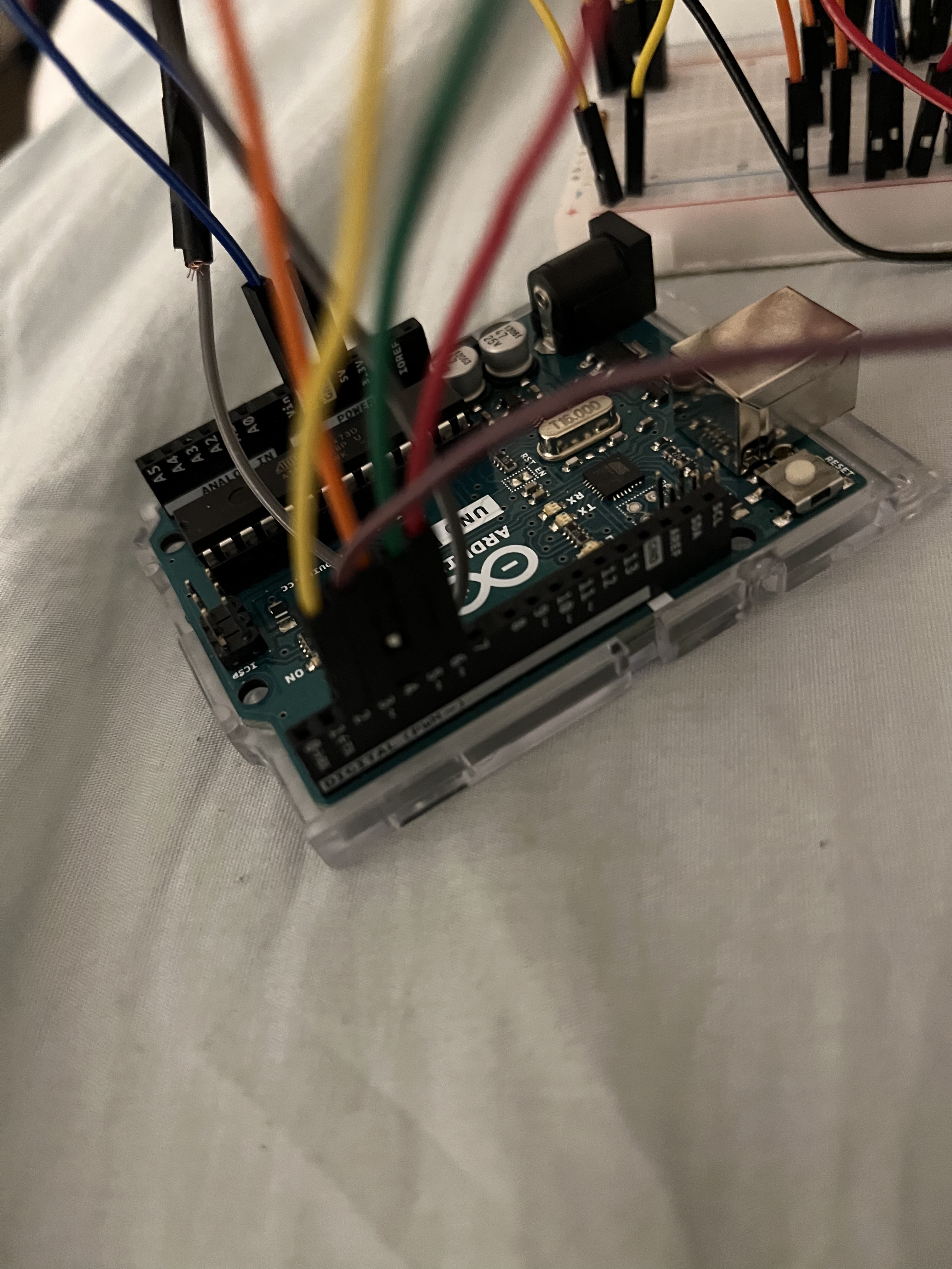

How did you get to all those wires then?
Where is Arduino Pin 5 (GREEN WIRE) going? Transistor emitter?
One of the transistor legs is not connected on your breadboard.
Sketch out a rough, hand drawn, schematic showing the intended wiring so we can compare with the actual wiring.
Its hard to tell if it's right if we don't know what it's supposed to be! :smile:
