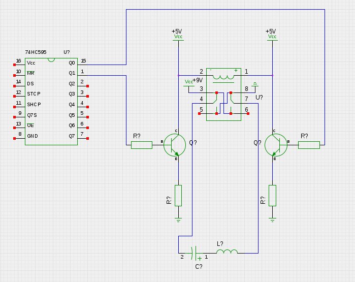

Been thinking about it for a while and this is what I've come up with (in attachment).
@CrossRoads: light background XD
Uses 2 pins of the 595 (sigh) for each relay and takes careful coding on the MC's side. Apart from that it seems to me like a viable (low tech) solution.
AFAICS it features 0 power consumption when the 2 transistors are off, the relay being of the latching type and requiring only a few ms pulse on either direction.
I'm unsure however where to put the protection diode around the relay's coil ( guessing I'll need 2? ) ... could someone please lend a hand on that?

Much more readable, thank you.
You have both relay coils connected to +5; that won't work.
You need more of an H-bridge setup so that current can flow both directions.
See L293DN.
Maybe the Arduino can drive the L293 directly with 2 pins to drive the latching solenoid directly. Then skip the shift register and relay.

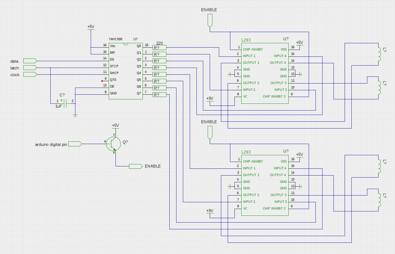

Downloaded its datasheet and drew the attached schematic. Still using the 595 as only 4 solenoids would munch 8(!) of the atmega's pins...
Pretty straightforward stuff until I got my eyes on the specs... this little puppy is a power hog!!! Looking closely, in the worst case scenario, even with that little trick, depicted on the schem by disabling the chips until needed, I could be facing a steady 28mA draw per chip! :frowning:
Please correct me if I didn't interpret the datasheet correctly.
This is all, of course, theoretical as I don't have this one in my components stock and can't make real measurements. It was all from the datasheet.
At this point, unless I'm a total dunce who doesn't know how to interpret a datasheet and needs someone to set me straight :sweat_smile:, I'm much more inclined to adopt LarryD's suggestion and carry on with the relay approach. Much less complex a solution and more power savings AFAICS.

I would have thought 8mA typical with all outputs at high impedance, datasheet page 5.

A high current shift register, TPIC6B595, might be a better choice.
Supply current is very low when not switching, similar to HC595.
HC595's only support recommended 8mA, and absolute max of 35mA.
Yes I saw the same at page 5. That only accounts for the logic side right?
Because I'm reading, perhaps wrong, that there's more power being drawn on the output side.
I considered the product of the logic and output sides max values as in the "worst case scenario"

When not driving - all outputs Low, or High Impedance , the motor side shows 2mA typical.
6B595 is a nice chip, I use it a lot. Thanks to Boffin1 for pointing it out originally.
