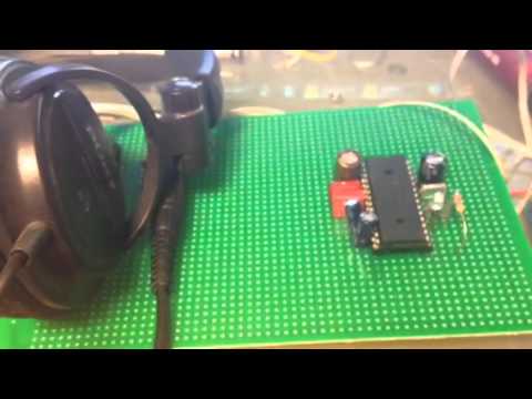

I'm building a Headphone AMP with Tone control using the LM4832. Cheap to buy on Ebay.
This way I can have a better and Powerful sound than I can get direct out of my IPad and/or IPhone ![]()
First test are looking good ![]()
This Sketch should awaken the LM4832 and you can get a LED to Flash on the General output.
Download the Datasheet and you can control the other features of the LM4832 ![]()
HeadPhone Amp controlling LM4832
