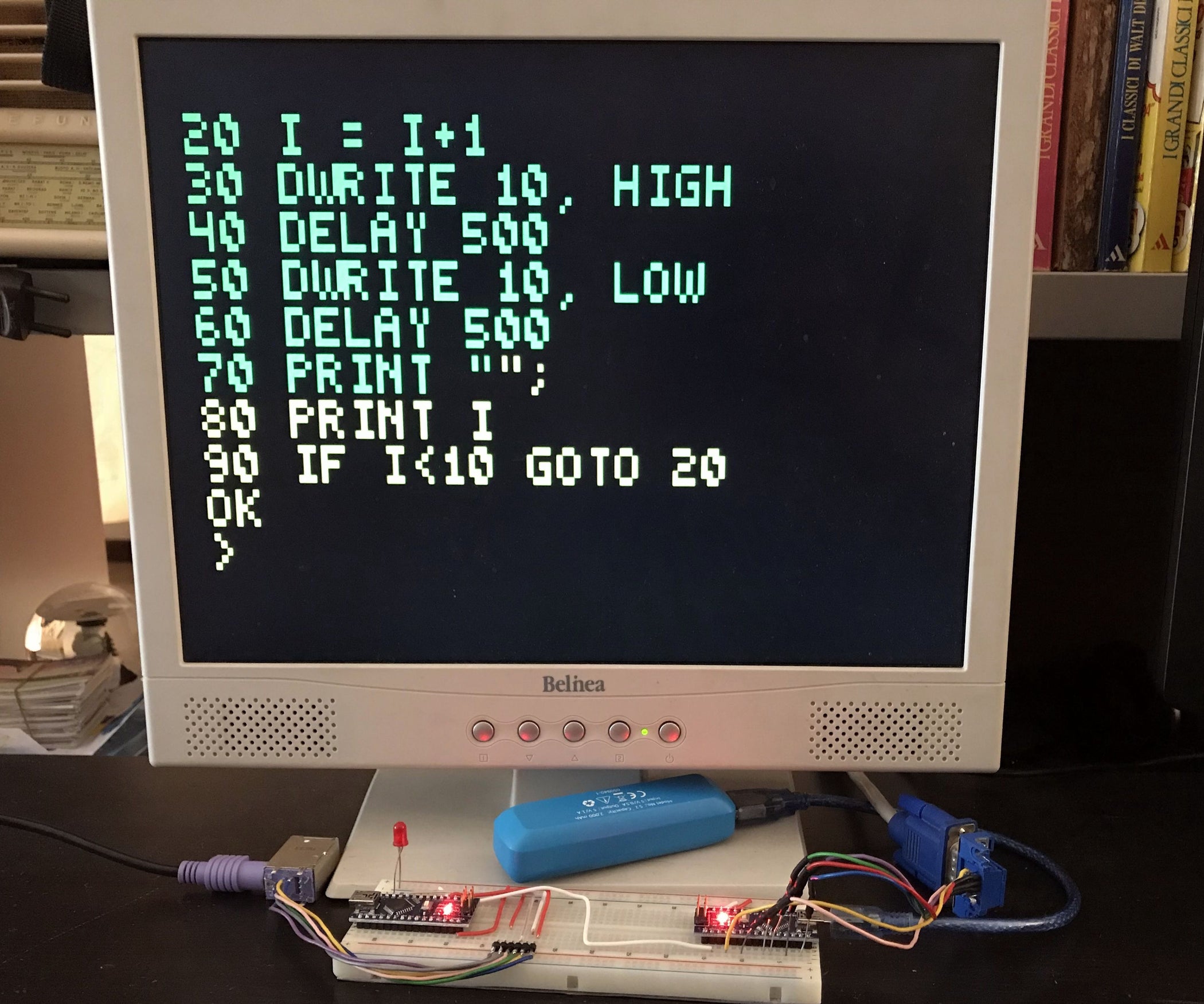

Didn't Google turn up anything for you? I started a project like this last year, never finished. But a search on something like "VGA pinout" led to signal information.
None of the projects I saw, used an "adapter". The VGA signals were produced in software and presented on output pins, translated by a simple transistor/resistor circuit to VGA signal levels.

Here is how to do it but you are going to lose some functions
Hi
Best way to do that and keep your coast low is to use two Arduino s one for the VGA and the other to do your stuff like this project
