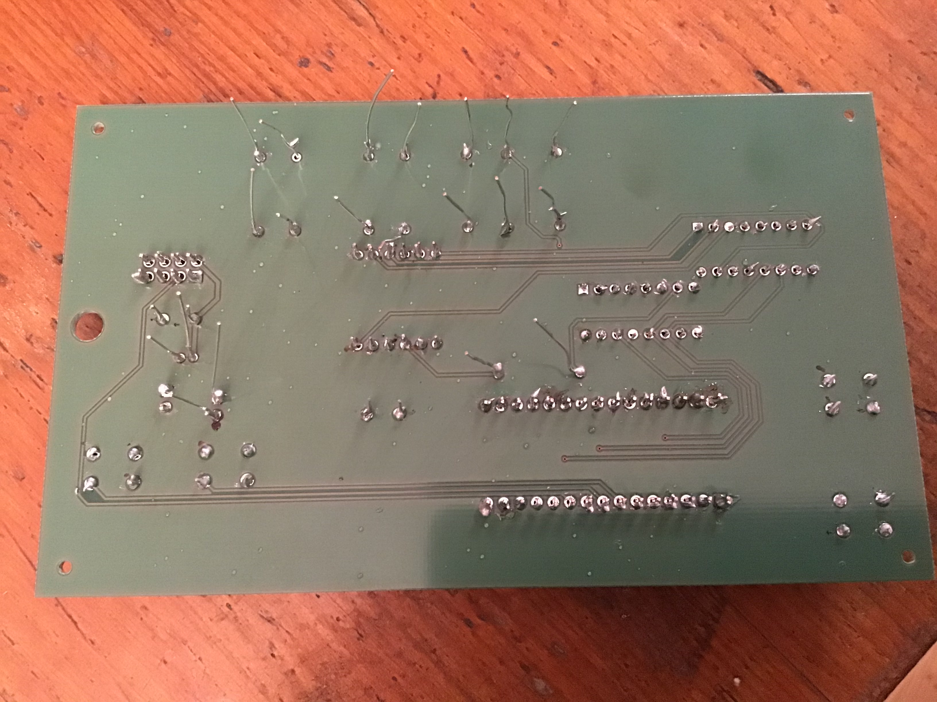

Arduino doesn't function on PCB
Hi, I'm building an RC car transmitter. I soldered components onto the PCB, which I designed, link is here (EasyEDA(Standard) - A Simple and Powerful Electronic Circuit Design Tool), GND is connected by copper pour on the top and VCC is connected on the bottom by copper pour.
When I connected Arduino NANO to battery it did't function, so then I tried to connect it do computer, but any diode did light up on the Arduino. What could be the problem? In my opinion, the problem could be that I connected GND and VCC of the battery reversely, but I'm not sure, whether I did it that way.
Here is the PCB from back
Re-solder your connections, use liquid soldering flux to get proper fillets.
If you connected the power the wrong way you might have damaged the Nano. Is it soldered to the board or is it plugged into headers? If you remove it and power through the USB connector and it doesn't work then I think you have your answer.

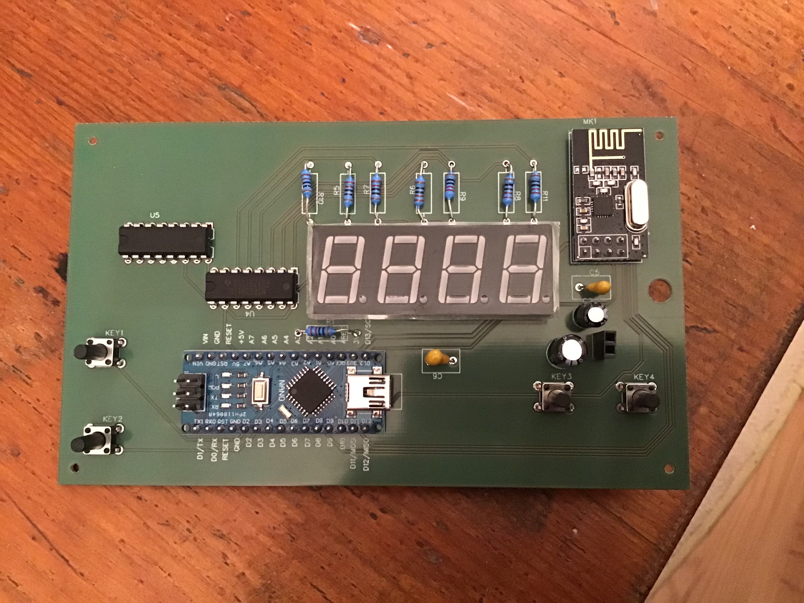

Is the device in the top right WiFi? You will possibly have problems with the signal because there is copper directly below the aerial. If you have a problem use headers to lift it up from the board. Ideally there should not be copper underneath.
I would make the board with no pour in the top right corner or hang the aerial over the edge. Or both.
Thank you and yes it is Wifi. So should I remove the NANO and replace it with another one? Is the PCB layout ok?

Larry is right about your soldering, I can see a lot of very suspect joints.
The radio won't work, or will have only very short range, if there is any copper on the PCB underneath the "F" antenna trace. It looks like you have two solid layers, so you'll probably need to design and order another board. Or cut away a chunk of it, under the radio.

As suggested above, no offence but you soldering is horrible. On the bottom the 2nd in on the top left looks like it is not even soldered.
I don't know if your iron is too big, or too cold or you technique needs developing. As larryd showed the solder process is rather quick if the iron is the right temp. I can usually heat and solder in ~ 2 seconds.
Regarding you PCB. It looks OK but I would:
  1. increase the width of the traces. No need to use the minimum if you have plenty of room
  2. increase the via diameter (drill and annular ring) for the same reason as #1.
  3. I would add some pads for ground and Vcc to make it easy to measure them.

When I connected the battery nothing happend and none of the diodes did light up. When I connected the USB, none of the diodes on Arduino did light up and computer couldn't find a port.

When I connected the battery nothing happened and none of the diodes did light up. When I connected the USB, none of the diodes on Arduino did light up and computer couldn't find a port.
Unfortunately is doesn't good. Like you suspected you likely toasted the nano.
I Can't tell if the Nano is soldered in or not. I suspect it is. When replacing I would put female strip headers on the board so you can plug and unplug the Nano
