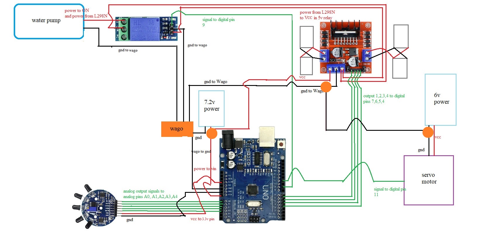

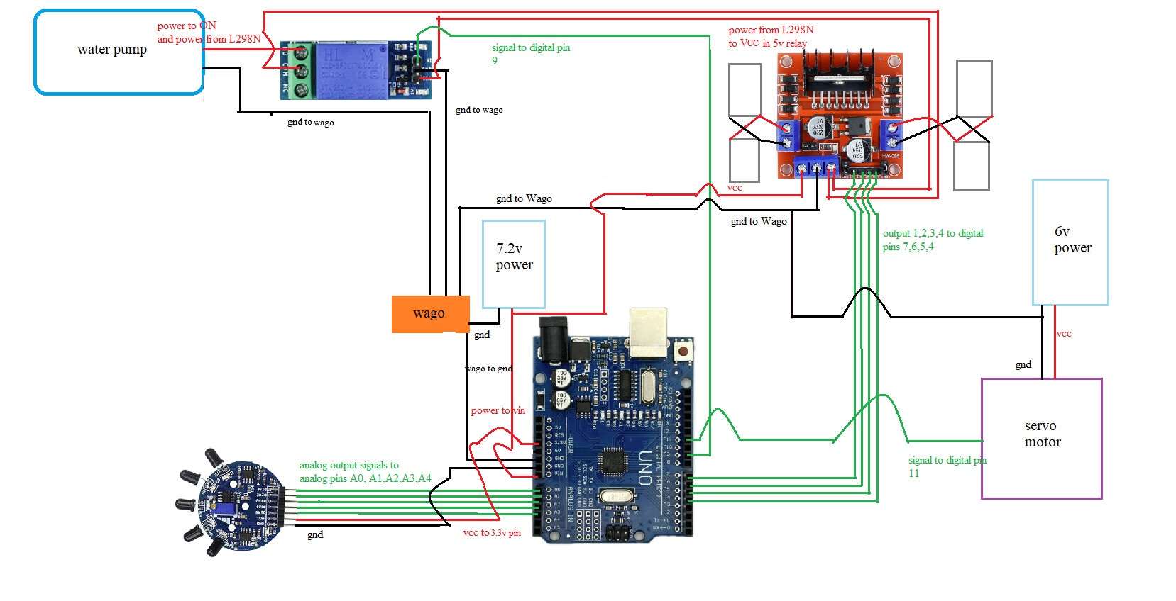

I have some problem with code or with connections, always when I start my car using button, water pump is on and it isn't going off, please help. I know I didn't finished code yet, but this is first thing that I want to fix. There is code and diagram:

vojkan123:
Someone can only help if they know how you have wired up all the components in your project. You gave the code, thanks, but where is the schematic or block diagram? How does your program turn on the pump?

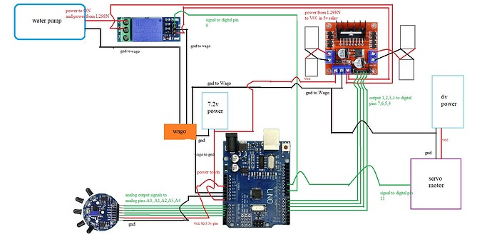

My drawing is just scheme. Without any code for pump, It's still working, so I think there is problem with connection
I added some wagos (orange circles) too in my real project, easier to connect, so it looks like this
Your diagram shows pin 9 controls the pump relay, but your code says pin 8 controls the relay.

yes, my bad, on project it was pin 8, I forgot to change drawing
Thank you, pump is off now by default
