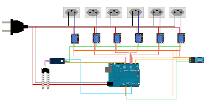

Hello people!
Can someone help me with this draw for my system controller online of garden?
I had already burned 1 shield and dont know what can be wrong D:
Can this connections burn my ethernet shield? Is something wrong?
What should i know to build a system like that?
Thank you!
Hi, and welcome to the forum.
There is no ethernet shield or power supply in your Fritzing.
The six 5volt relays alone could draw 6 * 80mA = 480mA. Add an ethernet shield, an Uno, and some sensors to it, and you could be way over the current limit of the onboard 5volt regulator.
Before we go any further, I suggest you post links to the parts you intend to use.
Leo..

The list of what im trying to use is:
And the power supply i was intending to use a 5v 2A USB phone charger but dont know if it works
Uno, sensors, and ethernet shield could be powered with a 5volt/1Amp USB charger, connected to the USB socket of the Uno. The Uno + sensors + ethernet will draw ~250-300mA.
Six relays (480mA) will push current over the limit of the onboard polyfuse.
I think you should use a different relay board.
This one has opto couplers, but no opto isolation.
Power the relays with a different (5volt/1Amp) supply.
Then you don't overload the Arduino, and you can have an extra safety layer (opto isolation).
2, 4, or 8-relay boards with a JD-VCC jumper are suitable.
Post a link here before you order.
Leo..

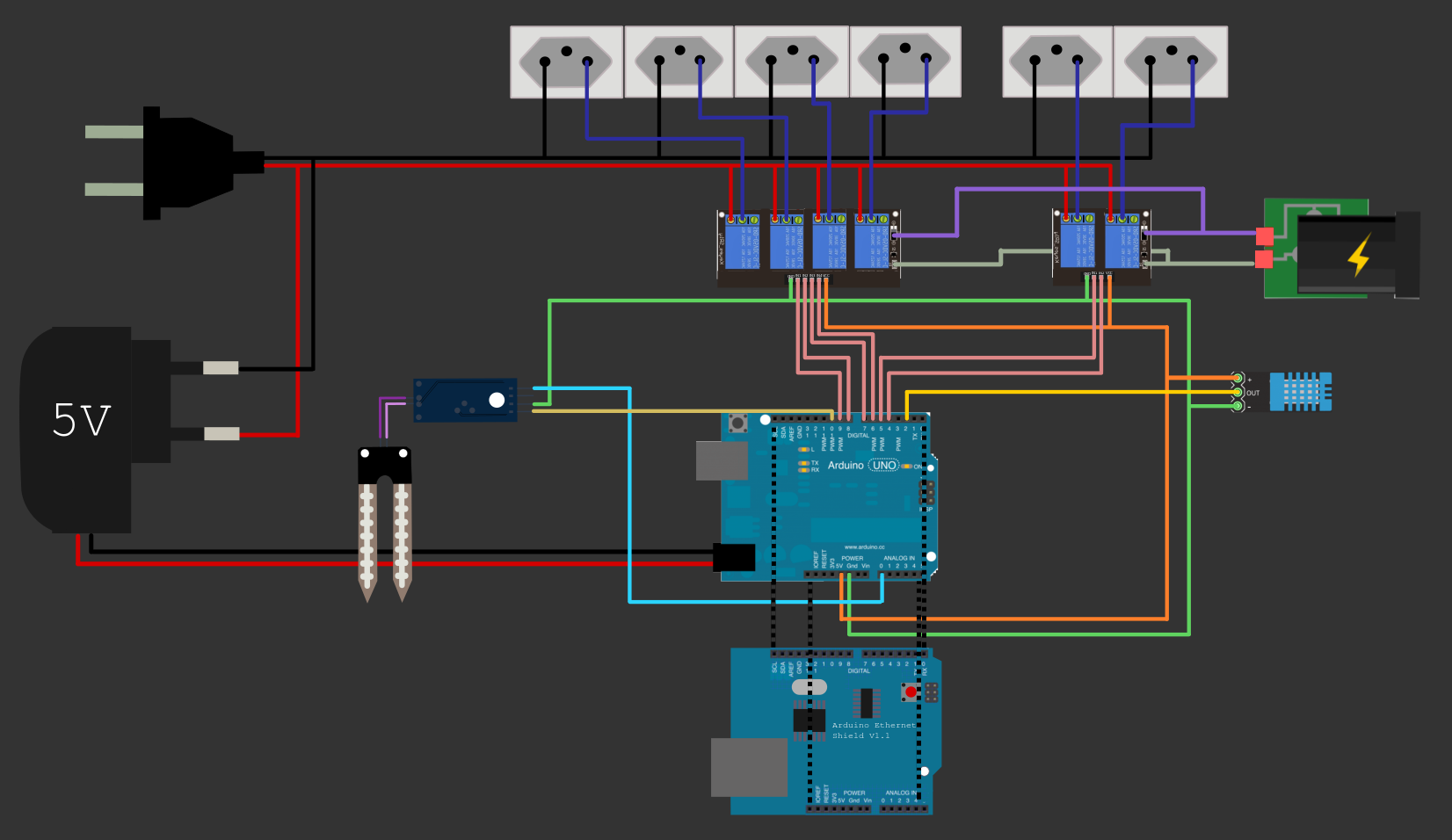

I have done another draw i hope this one is right
Thanks for the help! :slight_smile:
The DC socket of an Uno needs 7.5volt or 9volt.
DO NOT connect Arduino ground to the relay board.
Leo..
Where should i connect the ground of relay board then? Or nowhere?
Just wondering why you need to switch 110/220 Vac. Most garden watering valves operate on 24 Vac - much safer in possibly wet conditions!
I think you do need the ground of the relay board to be connected to the Arduino board gnd but those Fritzing diagrams are always confusing. A proper schematic is much clearer.
Russell.
paulap:
As explained in post#5. Relay board ground ONLY connects to the relay SUPPLY.
NOT to the Arduino.
russellz:
No, you don't.
If you do, you don't have opto isolation.
The opto LEDs of the relay board are connected between VCC and the input pins.
So you only need VCC and the inputs connected to the Arduino.
Leo..
