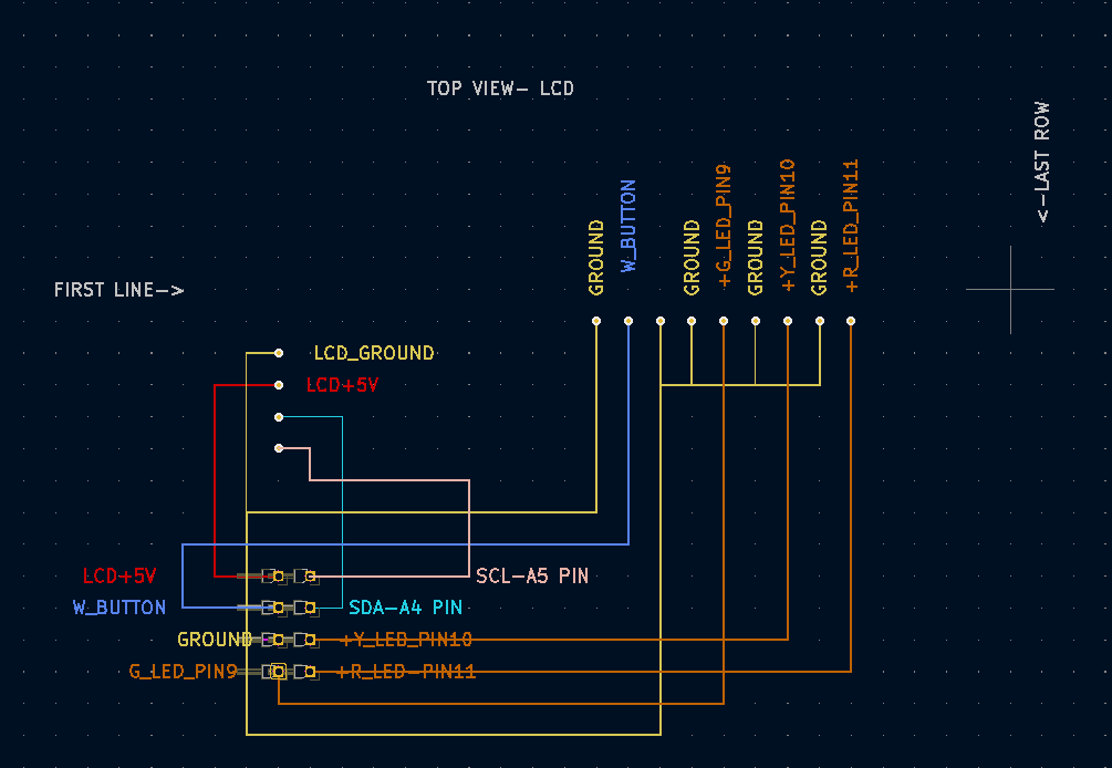

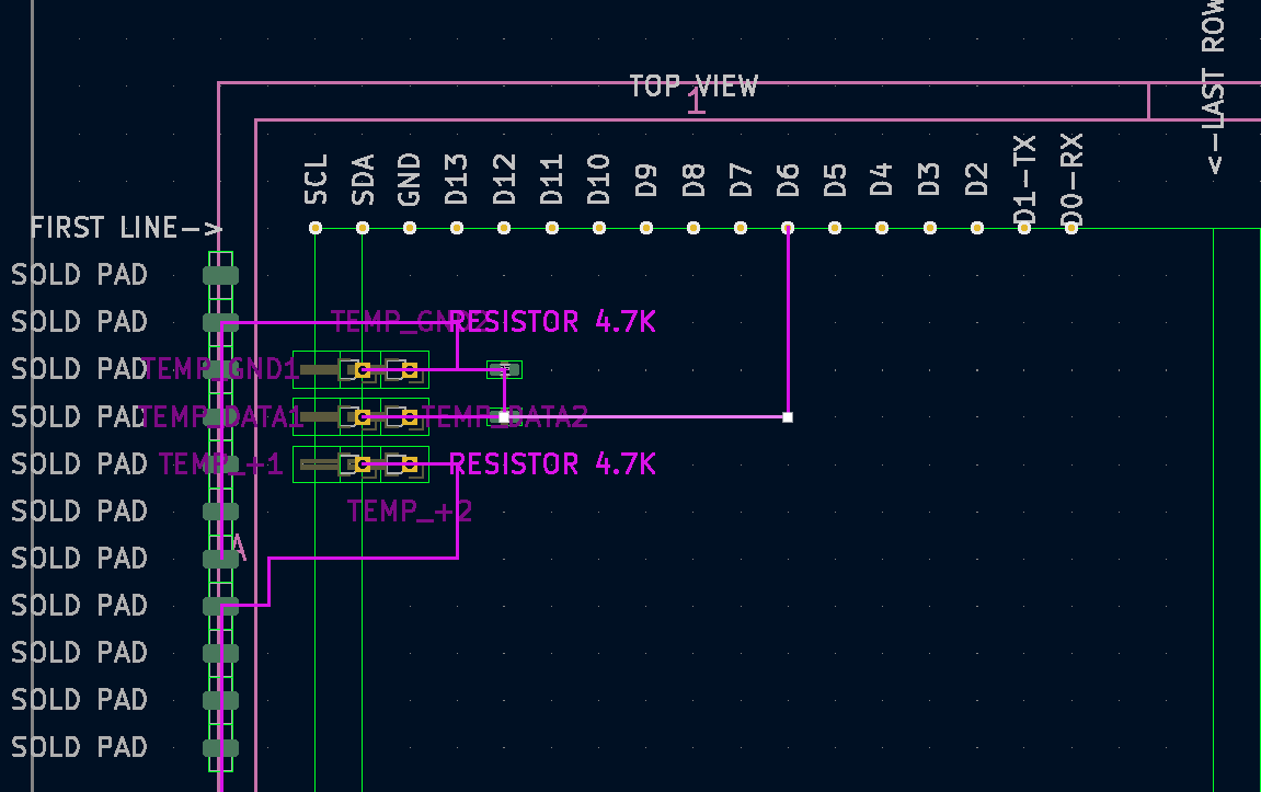

And my cables are kind like that:
Custom made PCB with two rows of 3 pins, common ground and +5V from arduino and common data wire with 4.7k resistor. Simple as that. What can i change?
I don't understand your wiring-diagram
looks fancy but is hard to understand.
Draw a schematic by freehand not a doublesided PCB-layout
I can see multiple 4,7 resistors.
You need only one single 4,7 resistor as pullup from data to +5V.
to narrow down the problem comment out all code related to the LCD
and just watch the serial monitor
Add serial debug-output to see where the hang really occurs

Wild guess: Is your GND wire to the Green led shared in some way with the GND to the display ? Or is the power to the Green led (the PWM signal) next to the wires to the display ?
Will try it later today and post results, tks
You are correct, there is a 8 pin dupont connector in a pcb, that goes as follows:
1)+led G 2)+led Y,3)+led R,4)Not used <- first row
5)+Lcd, 6)RX,7)TX, 8)Common ground for all leds and lcd. <- second row.

I'm thinking about hardware problem. Will post schema in a while

Can we look better into the hardware ?
Do you have a schematic of your project ? You may also draw it on a piece of paper and make a photo of it. Show all the power lines as well.
Where does the power of the LCD display and the leds come from ?
Would it be possible to connect the 4 wires of the LCD display directly to the Arduino board, and have those wires not connected to something else ?
How long are the wires to the LCD display ? Do you know that SDA should not be next to SCL ? I think you have to fix the I2C bus to the LCD display and probably add extra pullup resistors.
We should be talking about the I2C bus from the start, so we have some catching up to do.
Have you told us which Arduino board you use ?
I hope that you did not design your own ATmega328P board and forgot about decoupling capacitors.
There are two pcbs,one is like a shield for arduino (will post relevant schema later on) and this is the one with the lcd and the leds. Please dont mind the w_button, currently is empty. There is an utp cable with dupont connectors,around 1.5m, and currently i have remade twice the LCD pcb, tested all wires, no short circuits and no "power" lines come near close to sda and scl.There is common ground for everything, and lcd has standalone +5v straight from arduino
There are resistors for the leds
I'm sorry, but I have no clue.
Do you have an Arduino board ? Which one ?
Did you design a shield for the Arduino board ? With connectors ? Is the LCD display directly on the shield without wires and without a cable directly attached to a Arduino board ?
How can I see which pin of which Arduino board is used to power the LCD display ?
When you designed your own Arduino board and forgot about decoupling capacitors, then that is where to start. Someone on this forum replaced a cheap Arduino Mega clone with a genuine Arduino Mega, and that solved the problem.
i'm having an arduino uno r3 smd genuine.
I designed a pcb that fits on top, kind like a shield. No schematics for that currently.
I have an lcd with an I2C module, and i created another one pcb that connects with that module and also has places to add leds. The schematics for this pcb,are the ones i upload.
