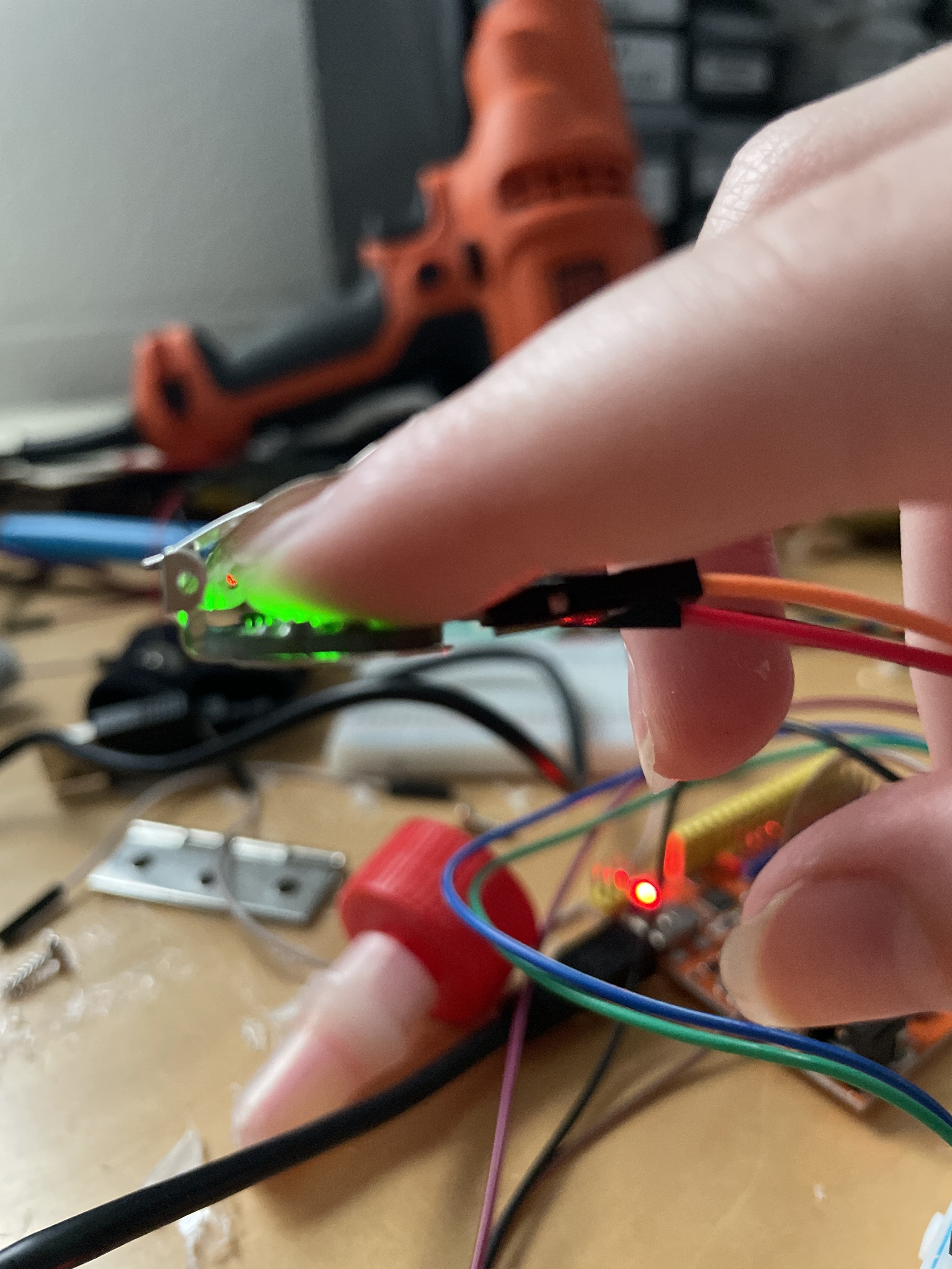

I’m making an anxiety/panic attack sensing device as a project for school, and to do it I’m using a series of sensors: heartRate sensor, GSR sensor, and vibration sensor. Most parts of the project are working, but whenever I try the heart rate sensor I either get flat 0 over and over again or just really unstable results ranging from 30 to 280, I’ve already tried adjusting the threshold and resoldering the wires on the sensor which were loose neither of these things helped. What else could be the problem?

How is the sensor attached to the body?
The tutorial talks about a sweet spot of attachment. Not too tight, not too loose.
I've tried every variation of tightness using the piece of velcro that came with the sensor. It only makes small differences, so I don't think that's the problem.

Hi, @Lizzy_Sky
What model Arduino are you using?
Can you please post some images of your sensor attached to a finger, and an overall image of your project?
