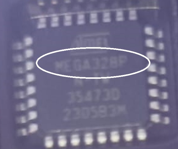

I purchased a new Atmega328 ic from the digikey. when the package is received I found that the number is different and I choose a different one. The IC I received is Atmel megaPN-TW 35473D 230583M, I checked the datasheet but there is no this kind of part number is mentioned.
Can anyone help me to check if this IC is original or fake?

DigiKey is a reputable dealer so I doubt it's a fake. The chip in the photo is a 328P
actually Atmega328P N-TW

Remember, these will need a Boot-loader added or be programmed with ICSP.
I've got an Arduino Uno R3 that has that same "35473D" on the 28 pin DIL ATmega328P.
That "230583" looks like a date code to me.
I found the https://www.tme.eu/Document/d0c4c512359c7f801dc03badc11b135c/GBNG-15KQFZ896.pdf that refers to two documents about the device markings.

Yes Larry, I though the same after I took the photo.
it 32TQFP package

The device in the image in post #13 is a 328, not a 328P. But the upload issue still is different from your original topic.
