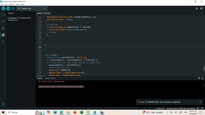

I use Windows 10 and have installed Arduino IDE 2.3.4, but I cannot work with it. I cannot open a new sketch, and I cannot modify the additional board manager URL.
What happens when you try to open a new sketch and/or add the additional board manager URL ?
Hello,
The following message appears
Error: 14 UNAVAILABLE: No conntetion established

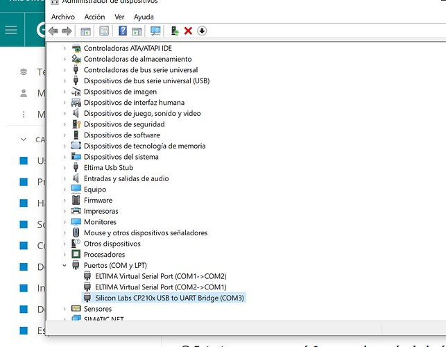

Which COM port have you got selected ?
I have selected the port COM3

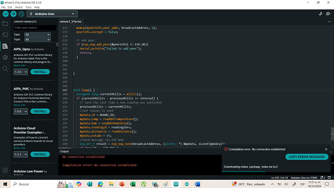

I cannot to modify de URL, always appear this text: un plazo de 5 años. https://dl.espressif.com/dl/package_esp32_index.json
Your additional board url contains crap (sorry for the wording); please clean it out. "un plaze de 5 anos" does not belong in there.
It is much easier to edit the additional URLs if you open the edit window rather than trying to edit it as shown in your screenshot
I have tried to modify the URL, but it does not change the text, it always returns to the same thing.
I try to create a new Scketch,
sterretje:
arduino-cli.yaml
I don't have these file in the folder.
You did not look at the correct directory.
I'm sorry, these the folder.
I deleted the file arduino-cli.yaml and I reset. all OK.
Thanks for you help me.
