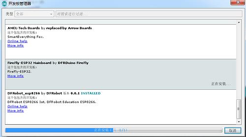

  1. Update the Board List
After adding the mainboard URL of ESP8266 (FireBeetle-ESP8266) to Arduino IDE, we need to update the board list, and use Arduino IDE to download ESP8266 libraries.
Open (Tools)-> (Development board)-> (Development board manager), as shown below:
After opening the Development board manager, the board list will automatically be updated, as can be seen below:

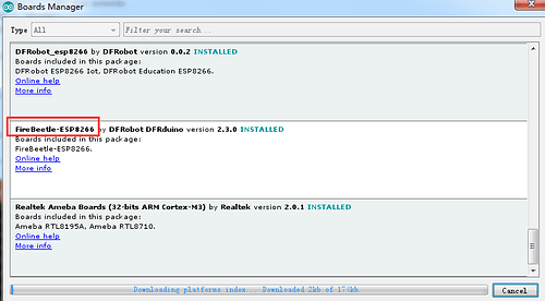

  1. Install ESP8266
After completing the update, you should find FireBeetle-ESP8266 Mainboard options which you can then edit
Select “FireBeetle-ESP8266” and click “Install” (I have installed). The manager will automatically download the relevant libraries.
Wait for the install process to complete
After installation, you should see INSTALLED displayed in the Development board manager. You may now close it.
Close Development board manager, and the whole installation is completed.

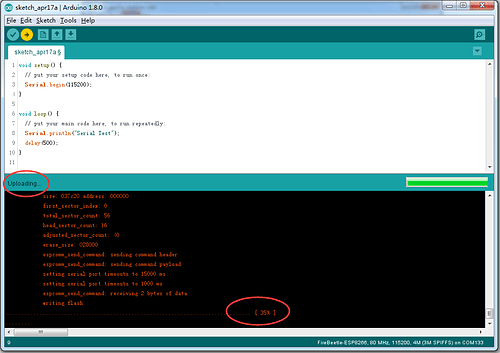

  1. Program Download
    Connect FTDI with computer, select corresponding port number and click “Download”.
Wait for the downloading to complete:
After downloading is completed, switch the Wifi Bee ESP module to BOOT end, and then re-power off and on.
Open the “Serial debugging assistant” of Arduino IDE, and you may will see the serial debugging information which is the printing information in the code as shown below:
Now we can see the print information correspond to the code.
