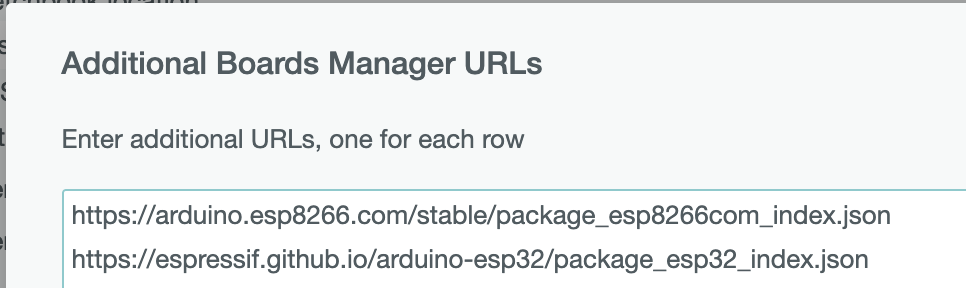

Hello everyone, I have the following similar problem: After switching to win11 and reinstalling Arduino, I am unable to install ESP8266 in the board manager. I always get the error message: Error downloading......

What is the additional board URL that you have added?
I do not know how long you have been trying, maybe it's a temporary glitch somewhere.
Ja, es ist genau diese Url. Esp32 hat sofort funktioniert, die esp8266 aich bei mehrmaligen versuchen nicht
Yes, it is exactly this url. Esp32 worked immediately, the esp8266 did not after several attempt

Ja, das ist möglich. Ich werde es auf alle Fälle weiter versuchen. Gibt es daneben eine andere Möglichkeit die URL in der IDE einzutragen
Yes, that is possible. I will definitely keep trying. Is there another way to enter the URL in the IDE?
Now that I have deleted the entire Arduino IDE, including all associated folders, after reinstalling version 1.8.19 the integration of the esp8266 has also worked. Why now, no idea.
