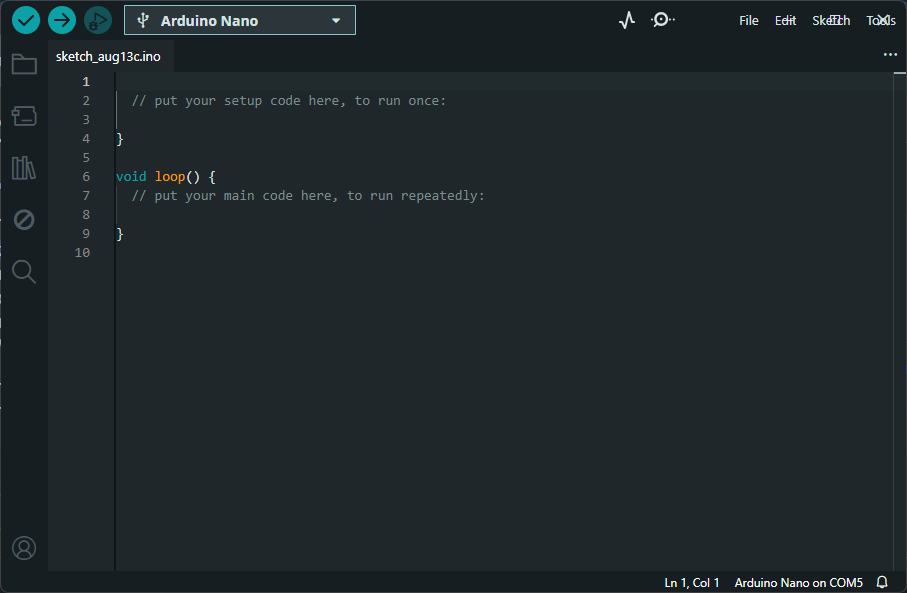

I am not sure how to describe this; when I opened the IDE, a message appeared that a setting has been changed, and to reload to take effect. The screen now looks like this:
and nothing happens when you press the upload button. Help?

extra information: i am new to this, and i was trying to get a servo working with my Arduino nano. I had a different window, but i declined to reload, and it looks fine:
Hi @vsci . The Arduino IDE developers are tracking this bug here:

If you have a GitHub account, you can subscribe to that thread to get notifications of any new developments related to this subject:
Please only comment on the GitHub issue thread if you have new technical information that will assist with the resolution. General discussion and support requests are always welcome here on the Arduino Forum.
Unfortunately I don't know of any persistent workaround for the issue. However, it seems to only occur intermittently so hopefully you will only encounter it rarely (most users don't encounter it at all, but unfortunately some do and it is not clear why).
When it does occur, I think the solution you found of declining the reload will be effective. If you do still have problems after that, try closing the Arduino IDE window. Hopefully if you open the sketch again the problem won't occur and so you will be able to work around the problem in that fashion.

whenever i open a new sketch, it has the same issue. only the original window which i declined on is unaffected.
