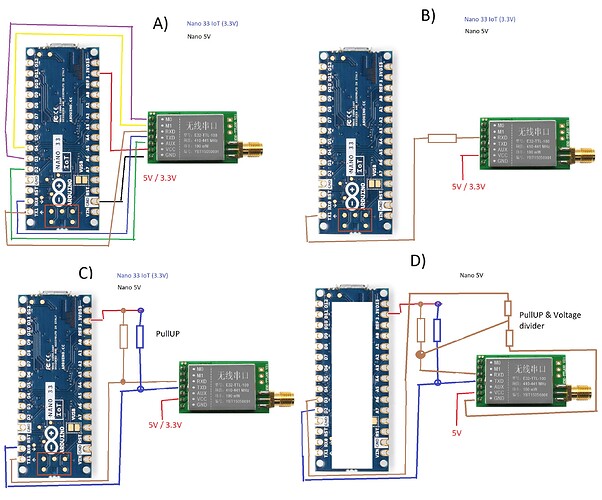

I would like to connect an Arduino IoT with AS32-TTL-100 but there are no drivers. It works partially with driver for LORA E32. I really don’t know if this driver can be used or I connected the hw incorrectly. The manual does not describe the use of PullUP & Voltage divider resistors, but it doesn’t matter if they are there or not, it does not work. IoT does not have SoftwareSerial or HardwareSerial I used Serial1. Can anyone advise me how to ensure that air transmission works?

Exit the program:
Sleep mode
Reset= OK
Info= AS32-TTL100-V2.0
Soft v.= 32T20-O32M-V4.01
Handsh= OK
Voltage= 3.19Volts
Konf= 0xC0 ,0xFF ,0xFF ,0x1A ,0x8 ,0xC0 ,
RSSI a= ERROR
RSSI g= ERROR
******* OK ********
RSSI aktu= ERROR
RSSI glob= ERROR
RSSI aktu= ERROR
RSSI glob= ERROR
RSSI aktu= ERROR
RSSI glob= ERROR
