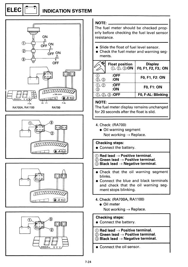

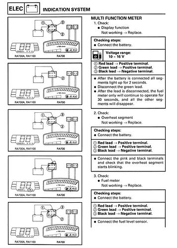

The sensors are already installed to my jetski and i want to read the data with the arduino and to project it in an lcd screen. The sensors are fuel capacity, oil capacity, overheating warning and speed tachometer. I have attached a photo of the original gauge. The wiring is RED and Green to Pos - Black to Ground - all segments will light up for 2 seconds - disconnect green lead and fuel meter only will stay lit for 30 seconds
With red green and black hooked up connect pink and black and overheat will blink.

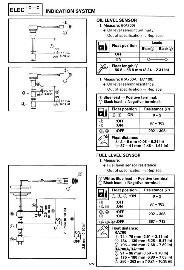

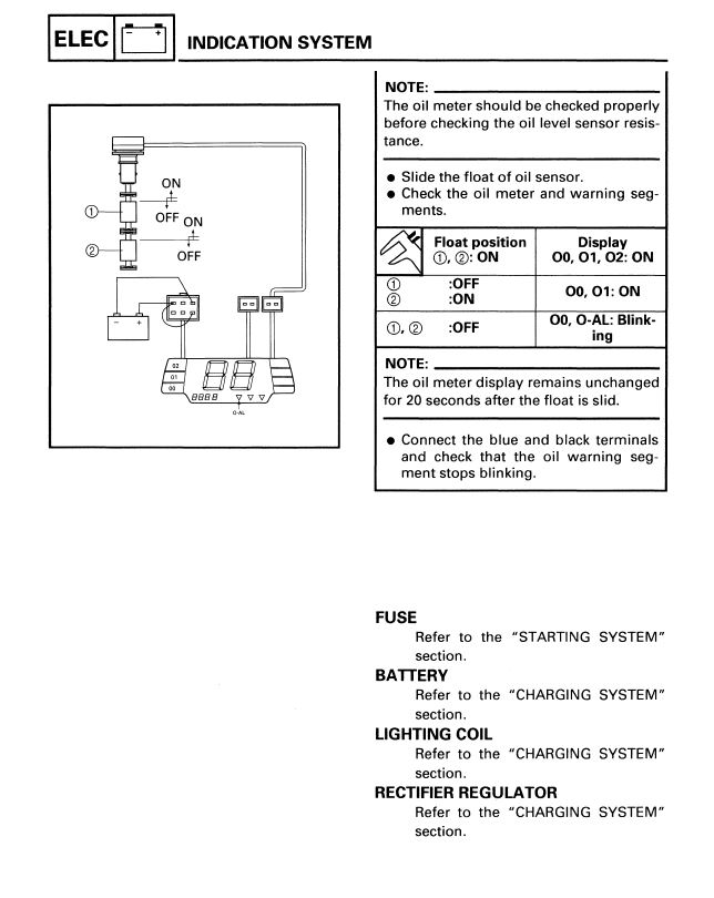

To test oil level blue + black -. Fuel level white/blue + black -.

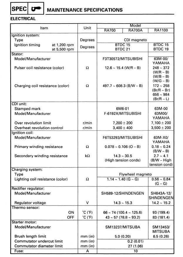

I have already the datasheets for the sensors, what's the next step?

Two of the sensors use resistance. If you do a Google search for "Arduino measure resistance" you will find many results including video tutorials.
yes, but how do i combine all these measurements in one lcd projection

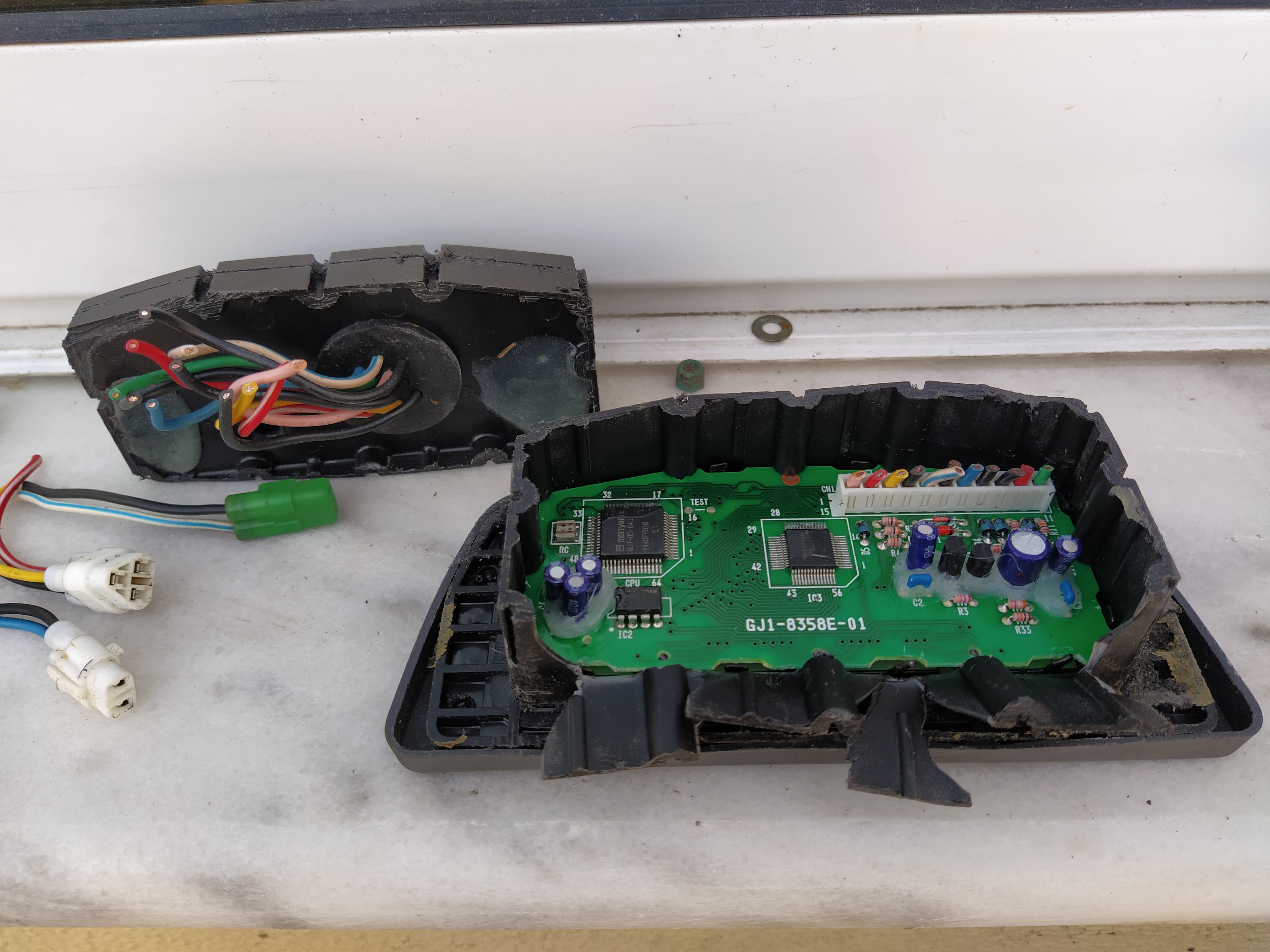

my unsuccessful attempt to open gently my gauge
Yeah, it's looking slightly soiled now. Pity, since fitting replacement electronics in the original enclosure would have been neater.
I wonder why the ICs have that "stripped" top on them. IC2 looks like a deliberate attempt to prevent reverse engineering. IC3 maybe ditto. But why the half-assed attempt at CPU?
