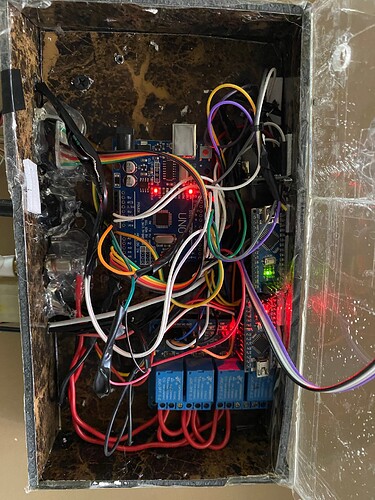

here how it looks i have also used 2 arduino nano. 1 arduino nano to controll fingerprint sensor and other to control ultrasonic sensor and a 4 channel relay module these 3 arduino trigger the relay. here i have powered everything with a mobile charger and when i measured the voltage its about 3.3v. now i have separated the power for arduino uno and df player mini. its been 1 hour and it is working fine but i dont know if it will still hangs or not.
any kind of mobile charger will deliver 5V at the plug.
You have to specify exactly at which two points of which PCB you measured the voltage.
Arduino Unos work on 5V.
On your picture I can see that you use an arduino-clone not an original uno.
Where did you buy this arduino uno? Post a link. If it was not amazon but a more professional online-shop than amazon is this shop provides tecnical specs of the board.
The microcontrollerworld is not super-standardised like USB-devives
With microcontrollers you have to care about more details than just
"does the plug fit into the socket?"
best regards Stefan
The Uno is a 5V board; it will not work reliably on 3.3V.
You are powering with an external power supply; which voltage? I can not see if your relays are powered from the 5V from the Uno. If yes, an Arduino is not a power supply. A schematic / wiring diagram (photo of pencil/paper drawing is OK) is better than some photos.
I think I’d like to see a wiring diagram - you have 3 Arduinos in there and a relay board !
I have to say what you have built is rather untidy and difficult to repair any faults .
It’s not related to the issue here - although modifying it isn’t going to be easy -
Start off by mounting the boards in a logical fashion , all the same way up, then wire logically using the same coloured wires for say the power supply , and so on.
It will help when your projects get complex or you want to go back to something a year later

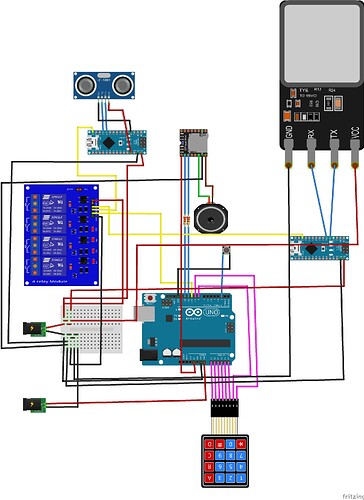

and this is the wiring diagram i have used in my lock.
typical amazon. Unimportant things like packet size and weight are mentioned but not really the operating-voltage. This is the reason why you should not buy electronic components at amazon. A customer asked for the operating-voltage and some person answered 5V.
The picture looks fancy but it takes additional time to analyse it.
A handdrawn schematic is way better.
If I should analyse it I would re-draw it by hand with straight-forward connection lines
instead of realistic pictures.
And you haven't specified what voltages are at the plug-sockets
best regards Stefan
It has the appearance that everything is powered from the arduino(s?) itself - which is where the issue probably lies .
These Fritzing diagrams are NOT schematics and not easy to read .
When this issue is solved spend some time on researching schematics too- I think there are some helpful tutorials on this site .
there are two input jacks for power each jack is fed 5v. there is a separate 5v power for arduino uno and rest everything is powered from another 5v jack. i have separate the power of arduino uno as it takes more power than other component. but i feel like when arduino has trouble communicating with the df player mini then the issue arrise it just hangs and doesnt respond to anything.
5V should go to the 5V pin, not to Vin. This applies to both the Nano and the Uno.
What is the specification of the power supplies? 5V/1A or 5V/2A or ...
