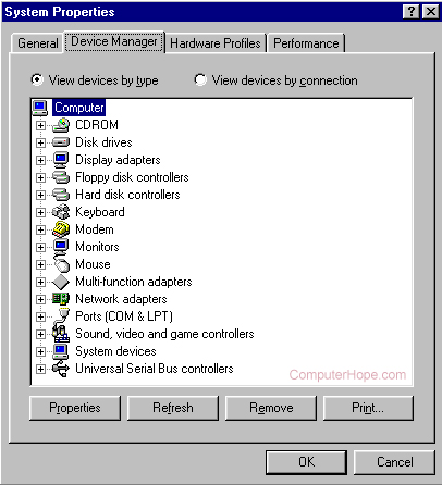

Here's how you open Device Manager:
After that, plug in your Leonardo, then tell us whether you see a new device show up in the Device Manager tree.

Hello
I followed your instructions and a new device did not show up.

8
Usually that means you're using a damaged or charge-only USB cable. Verify the USB cable works for data (not just power) on another device.
May also need a specific driver for the USB chip on board, i.e. CH340 if made in China.
