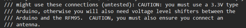

did you read the caution #1 ?
Your MEGA is a 5V device...

If you connected the 5V logic level signals of the Mega to the LoRa device, you could have damadged the LoRa device since it needs 3.3V logic signals.
Study the text of the Sketch you posted;
"CAUTION: you must use a 3.3V type Arduino".
Much easier to use LoRa devices with 3.3V Arduinos.

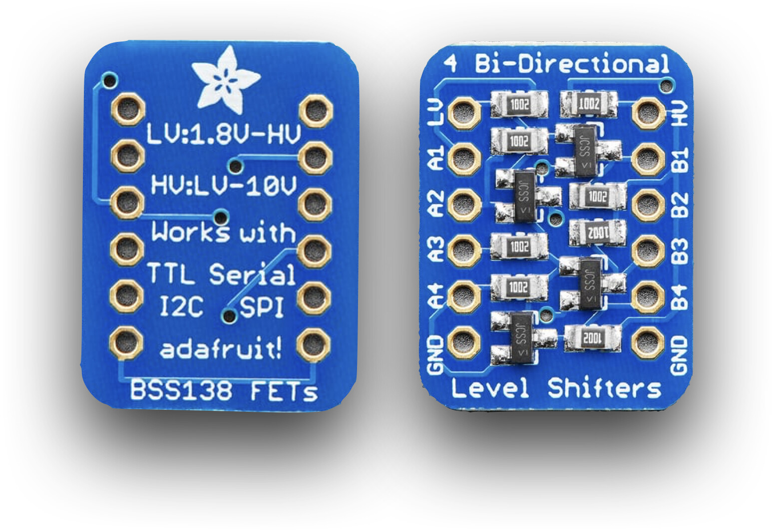

Get a voltage adapter board and use it to translate the signals -something like 4-channel I2C-safe Bi-directional Logic Level Converter [BSS138] : ID 757 : $3.95 : Adafruit Industries, Unique & fun DIY electronics and kits

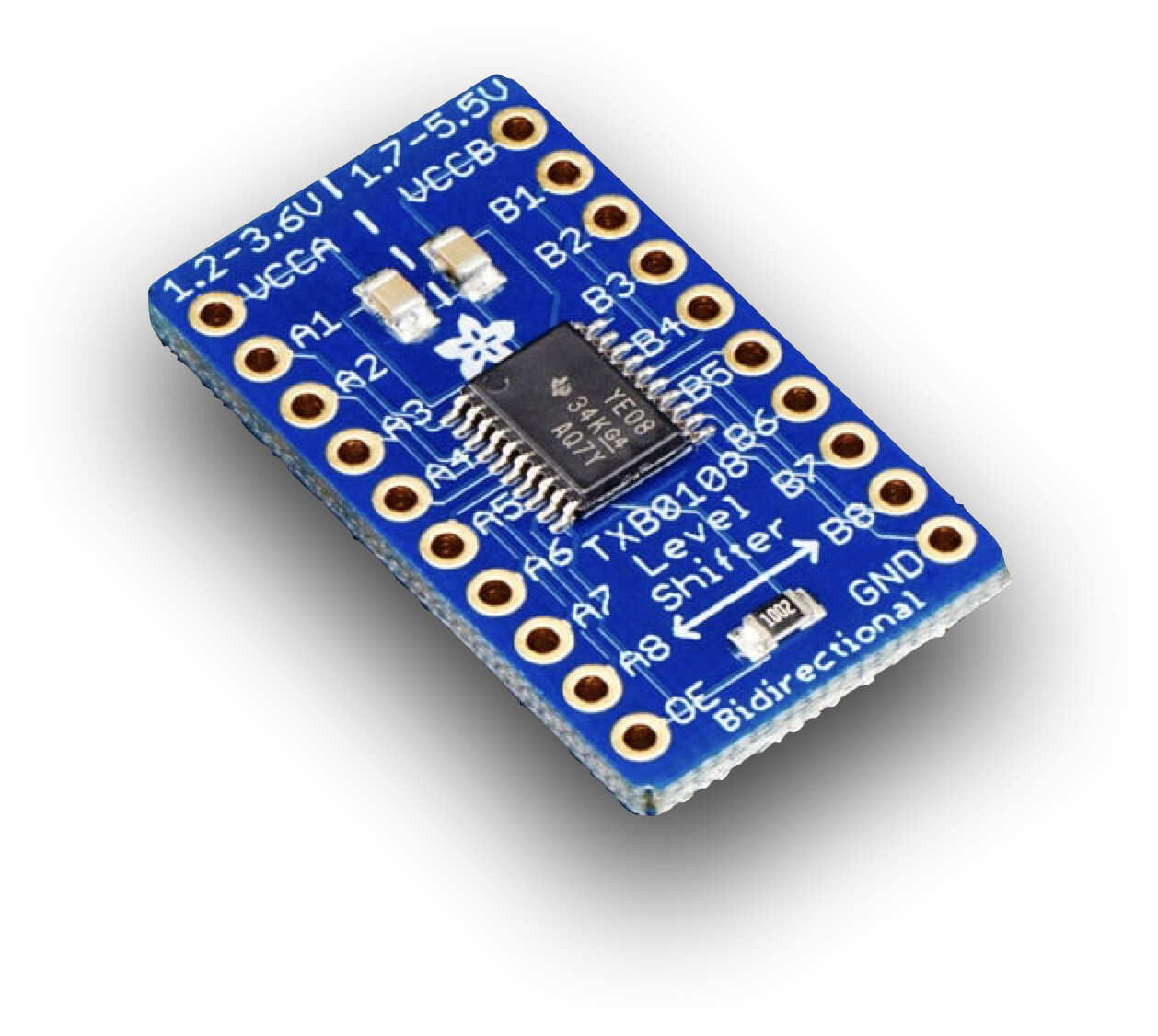

Thank you for this! Question, should I also use this for the RST and DIO0 pins?

if you need to shift more pins, there are 8 way modules like 8-channel Bi-directional Logic Level Converter [TXB0108] : ID 395 : $7.95 : Adafruit Industries, Unique & fun DIY electronics and kits
did a search and thank you for this! just ordered one and hoping all goes well once it arrives. again, thank you!

Hello, update regarding this.
The TXB0108 arrived however, it still doesn't work.
Wired it like this
LORA------LLC------MEGA
3V3---VCCA--VCCB-----5V
MISO-----A1--B1----------50
MOSI-----A2--B2----------51
NSS-------A3--B3----------53
SCK-------A4--B4----------52
RESET----A5--B5-----------9
DIO0------A6--B6----------2
The gnd of the LoRa is connected to the Mega.
Any idea how this doesn't seem to still work?
Does the Logic Level Converter have LEDs that light up? Because if it does it's not lighting up..
