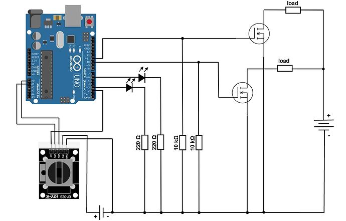

I am using an arduino micro to control a mosfet using pwm. The mosfets drain is connected to a load which is connected to a laboratory power supply. However, as soon as current starts to flow, the program interrupts and the COM port is disconnected too.
The thing is: this does not happen every time. Sometimes I can get like 400mA to the load. Sometimes it doesnt let current flow at all.
And another thing is: If I use this ciruit and use an Arduino Uno instead, it dont have that problem at all.
I have already read in other forums that this might be because Micro has some kind of fuse that resets the micro once too much current flows, or something like that.. but is that reasonable? The laboratory power supply is only connected to the load actually, so the current from the lab. power supply does not even "get in touch" with Micro? At least I think so.
Additionally I have encountered problems with micro before (randomly sitching COMports that are not even available etc.)
Can somebody please help me out?
sounds like a power supply problem
can you upoload a schematic of the circuit?
also the code (using code tags </>)

I that is so then it might be your problem. Your bench supply must have its ground connected to the ground of your Arduino to work correctly.
Please post a block diagram of your system showing how each component is connected together.
Also your load, you don't say what it is.
Is it inductive, like a motor or solenoid?
If it is what precautions have you taken to avoid the interference it will generate?

yes the all components have common ground. The load is just a resistance wire with R = 4-5 Ohm. The lab. power supply has a voltage of 3.6V.
I can't see anything that could cause the problem you are getting, although your diagram is odd showing batteries instead of power supplies.
The code has a couple of problems, but not any that would cause any problems.

All that leaves is the actual hardware, What exactly are the part numbers of those FETs?
Are you using solderless bread board?
That can make it difficult to make connections to things like FETs, depending on the package type. And all solderless bread boards are prone to not making reliable connections.
That is rubbish.
If you draw too much current from the 5V output while powering it from the Vin or barrel jack, then the regulator chip on the uno can get too hot which can cause it to shut down, if your lucky. But it also can cause it to be damaged and not work again.
I don't see any ground connection on the Arduino.
Well spotted, although, I think the "battery" close to the joystick is supposed to be the supply from the Arduino.

oh youre right, its just missing in the figure tho
How are you powering the Arduino?
Please update your circuit diagram and place in a new post.
Can you please post some images of your project so we can see your component layout?

I found the mistake and its a really stupid one! I soldered the the source pin to the wrong place on the ground...
But now its working again
Right now your other big big problem is that you are not using a logic level FET. That FET if you look at the Rds value only fully turns on with 10V on the gate. By using 5V it is hardly turning it on at all.
The threshold value is for where it turns off. So you are running in a sort of no man's land, and that will give you a problem with overheating.
