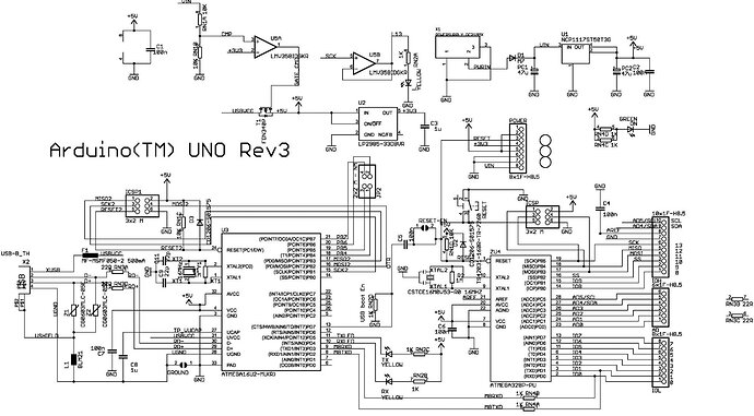

I'm a little confused around the power supply requirements for the arduino, as I believe the arduino can be powered from 7v-20v, yet also can be powered by USB. Preference from what I've seen is not to exceed 12v.
As I have 12v & 5v available from the ATX, I'm in doubt as to whether to use the 12v supply (which could exceed 12v) or the 5v - not sure how this would be connected or if it would be enough?
Use the 5V put into the 5V pin of an Uno development board.
The 7 to 12V is ran to a regulator on an Uno to bring it down to 5V. USB is 5V and is directly used to power the uno instead of being converted to 5V by the regulator.
