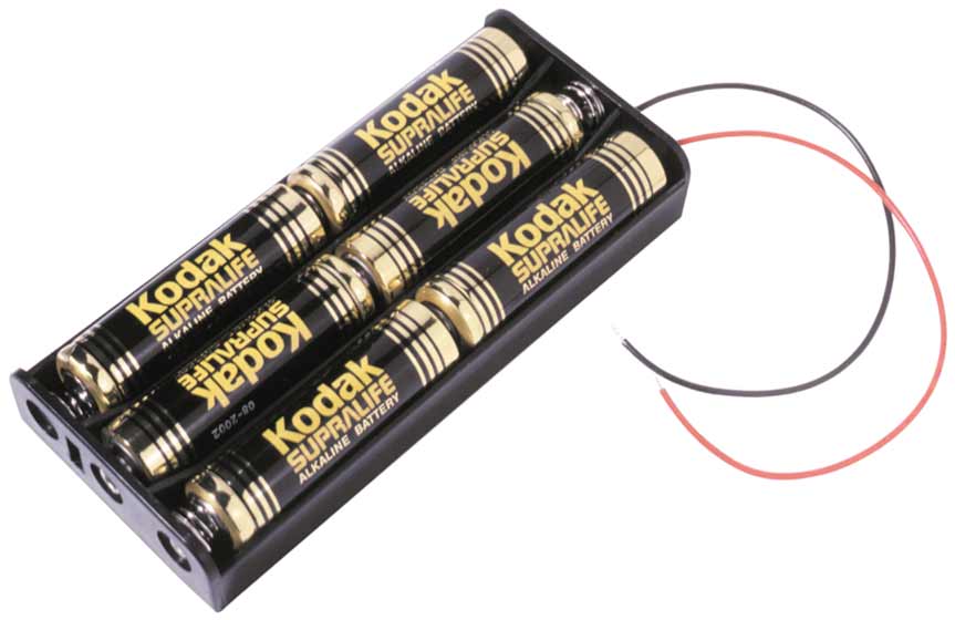

As far as Arduino projects go,
This is a 9 V battery:
This is not:
Your battery stresses the Arduino regulators and wastes power and money - one cell can be removed for ~20% savings.
In many cases 3 cells are sufficient to power 5V boards directly, at nearly 5V, or 2 cells for 3.3V boards.
I'm confused, one "square" 9v battery or 6 "round" 1.5v batteries. Why is the square one not 9v as far as the arduino is concerned?
Square batteries don't have that much capacity, maybe 400 to 500mAH.
AAA and AA have much more, like 1200mAH and 2500mAH.
3xAA (4.5V to 4.8V) might be all you need and will have longer run time than a square 9V.
