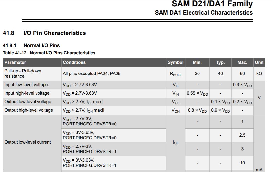

I would like to drive a single channel solid state relay capable of handling 120vac @<1amp as directly as possible from a mkr1000.
Small size matters greatly. Switching speed does not matter at all as the switching frequency will be less than 1 hz.
The relay will trigger as many as 3000 times per day and will need to operate for many years so it must be a SSR.
This application will pull a 120vac (low current) control signal to low for 1 second intervals based on the wifi and programmatic responses.
Can the mkr1000 WIFI drive any SSRs? Is there a better option that is the same size as the mkr1000?
There is a 5vcc available however size is very restricted.
Thank you
Can your mkr1000 light a LED? That is all it takes for a SSR.

Even a small Omron G3MB-202P SSR needs the same or a bit more current than a 3.3volt pin can provide.
Common SSR boards solve that with a transistor between pin and SSR LED .

How about this SSR instead, if you can live with just 825mA of switching current:
Can the MKR1000 drive 5mA?
Datasheet for the chip would suggest that at least some of the IOs can sink up to 10mA.

@CrossRoads This looks perfect!! THANK YOU!
