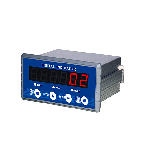

Have a good day. I am new to Arduino coding. I tried many programs on the internet to get the kg information from the weight indicator I have and write it to the serial port, but I failed. I need help from those who have experience with Arduino modbus master. I have a ttl to rs485 converter MAX485. I was able to read the kg information from the computer with Modbus Poll. I would be glad if you help me with a program that will write the kg information to the Arduino serial port screen.
M02 User's manual - weighing.pdf (1.1 MB)

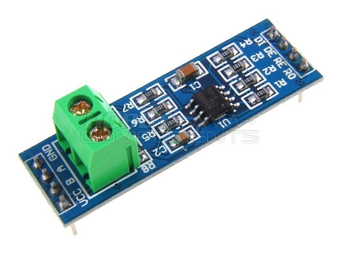

Show us your wiring - we need to see to which Arduino pins you have connected to DI, RO, DE/RE
It would also help if you posted the code you were using. Remember to place it between code tags otherwise it'll be hard to read and likely incur the wrath of the moderators :frowning_face:
I have uno, nano and pro mini. I tried many programs related to Arduino uno. I usually connected DI, RO, DE/RE according to the pins in the codes I found. DE/RE is usually combined into a single pin. I did not share the codes because I could not run them. If I find a code that I think will work with corrections, I will share it. If you have a Modbus master program that reads records from only one address, could you share it? In the Modbus tool, I read kg as low and high from address dec 0 plc 40001.
Ok. When you post the code, we can use it as a starting point to figure out what's going on.

but it would have been far easier for you if you had provided the information I asked for.
I tried your code with the connections below. I tried the Modbus connection with (A-A--B-B) and (A-B--B-A), but I couldn't get any output.
I found this code from the site below but I couldn't edit it according to my weight indicator. Can you help me with this? I just want to read the kg data at address 40001 according to dec 0, hex 0, plc address. 3 different data are read in this code. I added the weight indicator user manual.

If you don't see ANY output on the Serial Monitor - your wiring might be faulty.
You MUST be able see the Serial.println from setup().
Actually, this is the output I got
Weight indicator settings
slave adres 1
b rtu
8-n-1
Lo-Hı
you find all errorcodes in the ModbusMaster.h
E2 is
ModbusMaster response timed out exception.
The entire response was not received within the timeout period,
ModbusMaster::ku8MBResponseTimeout.
@ingroup constant
The master doesn't receive an answer.
I suspect a wrong wiring not fitting to the code.
Do you understand now why I ask for pictures?!?

What is the 115200 value in your weight indicator settings? Is that the baud rate of your RS485 port?
Way back in post #1 one of your screenshots indicated that it was 9600.
Could you drop the baud rate back to 9600 and try the code on post #6 . Rx on 2 and Tx on 3 like that code defines.
Abandon your will to use pins 0 and 1 for now.
Yes, the baut rate of the RS485 port. I tried both for your code. I can change the modbus settings with the F2 parameters in the weight indicator.
I did what you said and the result was like this
slave adres 1
9600
b rtu
8-n-1
Lo-Hı
Result 1 means illegal function exception. That means you have response from your device.
Replace this line: result = serverA.readInputRegisters(reg, 2);
with
result = serverA.readHoldingRegisters(reg, 2);
Yes it worked. Thanks for your help. How can we increase the scanning speed? Data does not come instantly. Rows come very late. When I press the loadcell in reverse - signed numbers appear as numbers with 65555 on the serial port. - How can I print signed numbers as 0?
