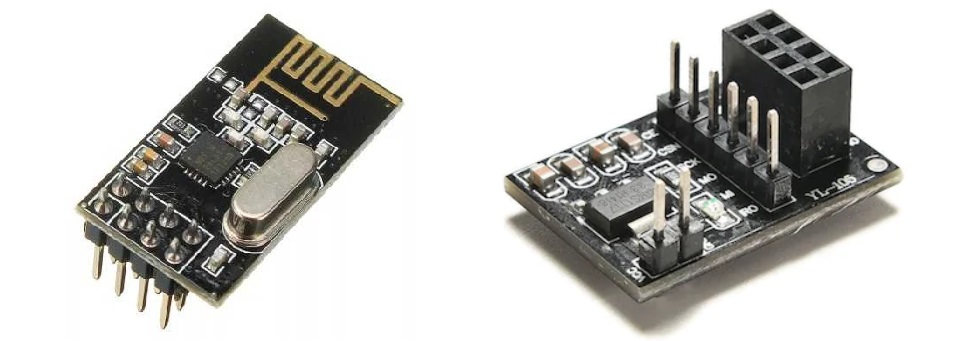

Have a nice day. I made a display that I can print numbers with bluetooth by getting help from the forum before. Again, I wrote the kg information from the weight indicator to the serial port with modbus by getting help from the forum. I wanted to send the data we received from modbus to the display with bluetooth but it was not successful. Since there was only one rx tx in Arduino nano and uno, I could not use bluetooth. I tried to send the data from the Arduino receiving data from modbus to the Arduino connected to the display with nrf24l01 RF modules but it was not successful. I could not make the necessary arrangements in the receiver and transmitter programs. I would be very happy if you could help me send and receive modbus data with nrf24I01 modules in this way.

Your transmitter code doesn't transmit anything, receiver code I don't know what it supposed to do.
Start with some tutorial to make wireless communication.
Yes, there are no sections related to nrf24l01 in the codes I wrote for this receiver and transmitter. I am trying to take the modbus data in the code I wrote for the transmitter and write it to the display in the code I wrote for the receiver. I tried and added the codes related to nrf24l01, but I failed. I will also try the code in the link you posted. Thank you for your help.
