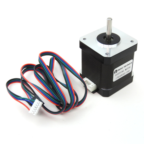

I want to control a stepper motor with an UNO and Arduino Motor Shield Rev3.
Four sets of questions:
Motor 1
NEMA 17
Rated Voltage: 3.06
Rated Current: 1.7A
  1. I want to power the UNO through the barrel jack. What voltage and amperage should the power source be?
  2. Am I correct in thinking I do not need to supply power for the motor through the shield with an external supply?
  3. If not, what voltage and amperage would I need from the external supply?

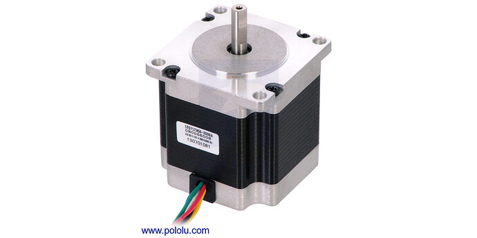

Motor 2
NEMA 23
Rated Voltage: 3.6
Rated Current: 3.0A
I know the UNO can only supply 2A.
4) Can I power the motor by supplying a separate power source through the shield?
5) If so, what should the voltage and amperage be?

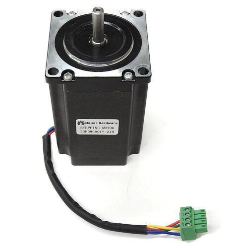

Motor 3
NEMA 17
Rated Voltage: 24 V
Rated Current: 1A
https://www.mouser.com/ProductDetail/SANMOTION/SF2423-10B41?qs=l4Gc20tDgJK5LLo07SiZAA==
  1. Can I power the motor by supplying a separate power source through the shield?
  2. If so, what should the voltage and amperage be?
Motor 4
Rated Voltage: 24 V
Rated Current: 3A
https://www.mouser.com/ProductDetail/SANMOTION/103H7126-5840?qs=F1JzWfReSMS%2BHuLovSVuwg==

The UNO board by itself uses something like 100mA.
The motors shouldn't be powered through the Arduino, and especially not through its voltage regulator. They should have a separate connection to the power supply or a separate power supply (with a common ground).
The motor voltage should "match".
**The motors will only "pull" the necessary current (**Ohm's Law) so the power supplies can be rated for more current.
You'll need separate power supplies for the 3V & 24V motors, or you'll need a good switchmode regulator that can supply 3V at about 4 Amps
The motors also have what is called inrush current, you will need to supply that when they start. Size the power supply for all the loads and then multiply the motor loads by at least 3 and add them to the total. This should get you to a minimum supply to run your loads. By sequencing loads you can cut the power requirement but what happens if there is a fault?
We are talking about steppers here. So both does not apply to those motors.
Where did you read that? A UNO is not a power supply, and it cannot deliver more than maybe some leds need.
In any case you need a separate power supply for your motors.
The Motor shield Rev3 is not suitable for your steppers. It can only drive DC-motors or high voltage steppers. All of your steppers need current controlling stepper drivers, which are able to provide the rated current of the steppers. The power source should be at least a 12V power source. The upper limit depends on your selected drivers. To select the PSU, you must add all the power your steppers need (NOT the amperage!).
