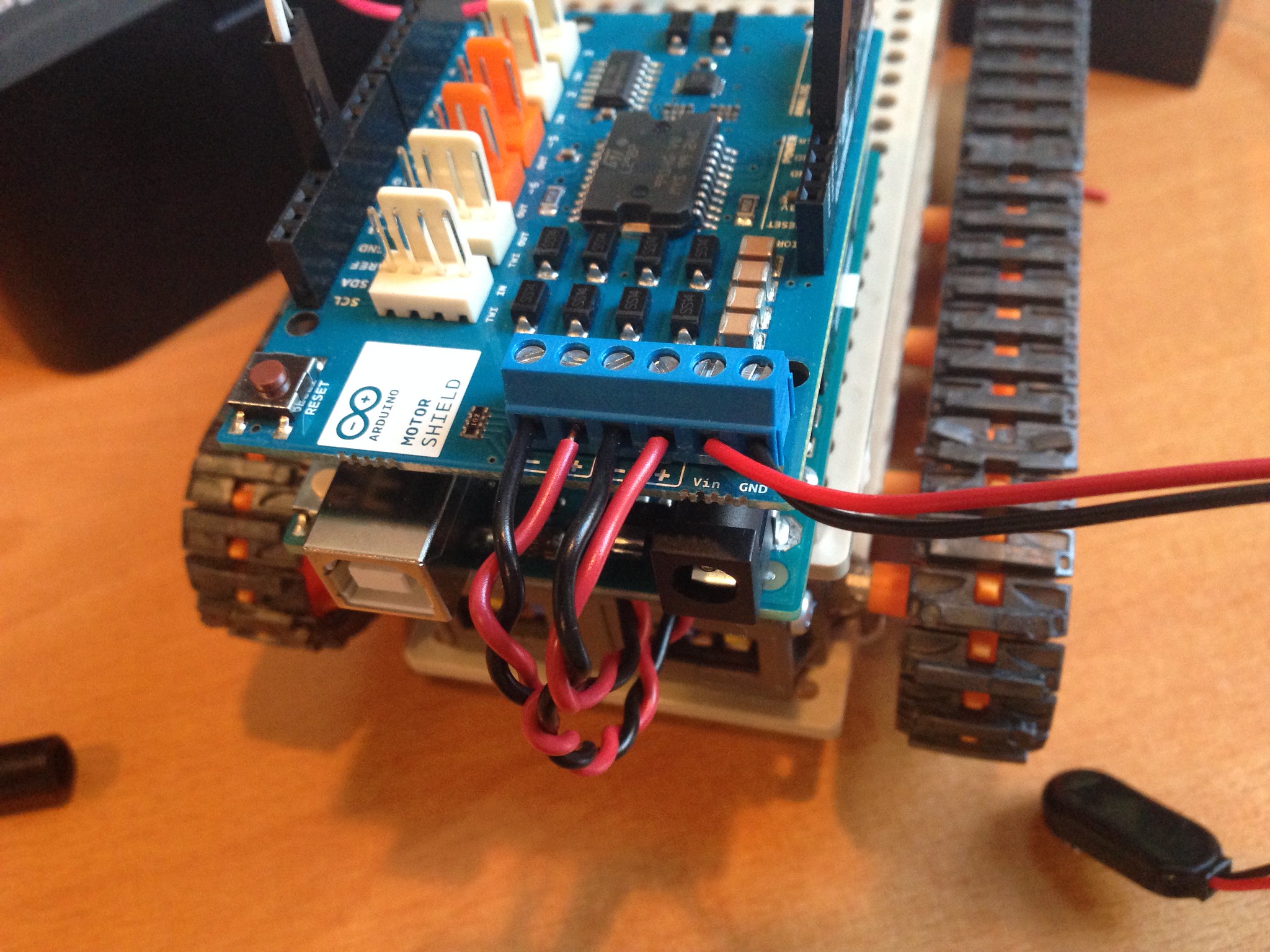

I'm extremely new to this and this is my first post, so please forgive me if I'm doing something really stupid.
I have an Arduino Uno 3 connected to the Arduino Revision 3 Motor Shield.
Here is the issue.
I can drive motor A or Motor B, but not both at the same time.
Here is my code:

If I leave the analog writes to the PWM as is - Motor A drives fine, but B does nothing.
If I comment out B, A drives fine (As expected)
If I comment out A, B drives will work
I thought maybe it was a timing thing so I put a delay in between the the two writes and only only A worked, but if I change the speed back to 0 A stops, then B starts for a few second and then stops.
Any ideas on why I can't get them both to run at the same time?
Can you take a picture of your wiring?
A link to the shield you are using would also be helpful.
What is your power supply?
What you describe sure sounds like a wiring problem.
Does the working motor start as soon as you turn on the power? Did you type anything into the terminal?
How did you "change the speed back to 0"?

The wiring is very simple:
I have a 9volt wired to the external power in on the shield.
I have one motor wired to A input and one wired to B input. (these are Direct connected)
There is nothing else connected on the board.
I tried putting the photos inline but it doesn't seem to work so here are the links.
Imgur
Imgur
I checked the solder points and bias on the motors using a battery. I've also checked the voltage on the motor terminals when the sketch is running. There is no voltage on B if A is running. If I comment out A in the sketch B runs fine.

The dreaded 9V battery! Those little batteries are the cause of many hobby robotic problems.
You need a better power supply.
AA NiMH cells should work well for that size of robot but the combined voltage of the batteries should be between 7.5V and about 12V (I'm not sure of the upper limit for your shield).
The datasheet of the L298P used by your shield states the motor voltage should be 2.5V higher than the logic voltage. Since you're likely using 5V logic the motor voltage should to be 7.5V or more (though it will likely work with a bit less).
The 9V battery you're using has a good voltage value but it can't supply nearly enough current for this application.

I will give that a try. I just had the robot on the floor and if I give it a little push the second track would move. It must have been getting stuck in a stall without enough current. I have a 6V and 3 volt pack. I'll run a test with them in series and report back.
UPDATE: My other batteries didn't seem to do the trick, but I have 7.2 2200 mAh at work, I'll need to wait a few to grab that. Do you thin that would work for testing or should I pull the trigger and buy a bigger 8.4?

In setup(), you don't make 'DIR_A' or 'DIR_B' outputs. That can't be helping. :slight_smile:
OldSteve:
Yes. Good catch.

I made OldSteve's correction to the code. I updated the code in my original post with comments to to reflect the changes in case anyone else ever makes the same mistake as me :).
The problem seemed to be two parts. I did need the better battery and I also needed to fix the code to initialize the other pins. I think when I first did the code I wasn't worried about direction and forgot it. The board was unpredictable without it though.

To bring everything full circle. The new battery arrived and that with the code correction has fixed the issue.
