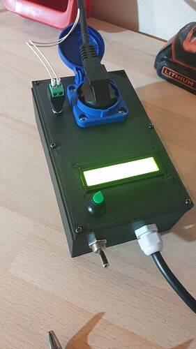

Arduino nano + 16x2 lcd for soldering station, weird characters

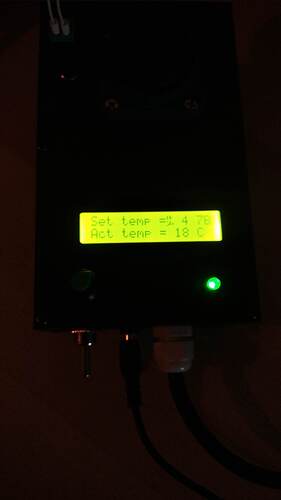

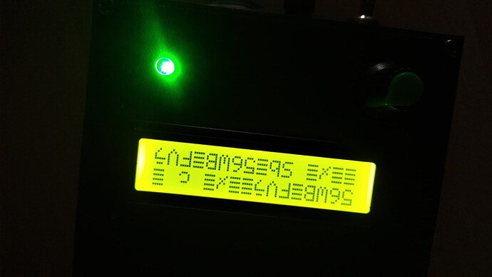

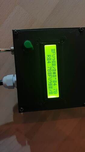

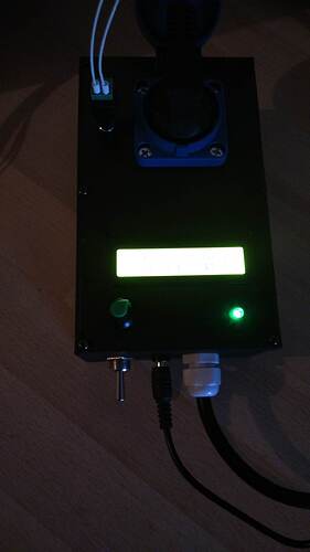

Hy everyone, i am struggling with a 16x2 lcd that keeps showing weird characters on the screen and i wasn't able to figure out the root of the problem.
Weird characters;
The setup is meant to control a cheap soldering iron;
  • using an SSR fotek relay to turn it on/off when it reaches desired temperature
  • arduino nano as the mcu
  • potentiometer to set the desired temperature
  • 16x2 LCD screen
  • a green led that is wired to the relay input to show if it gets signal
  • an input wire that goes through the relay to a socket for the soldering iron
  • an 100k potentiometer from an ender 3 pro, placed inside the tip of the iron where a have drilled a hole, it's wires goes from inside to the mains plug, tied with tape to the 230v cable
  • a 5.5v 3A socket psu that power the whole setup, arduino directly on 5v
  • a switch for mains power cable that goes to the socket

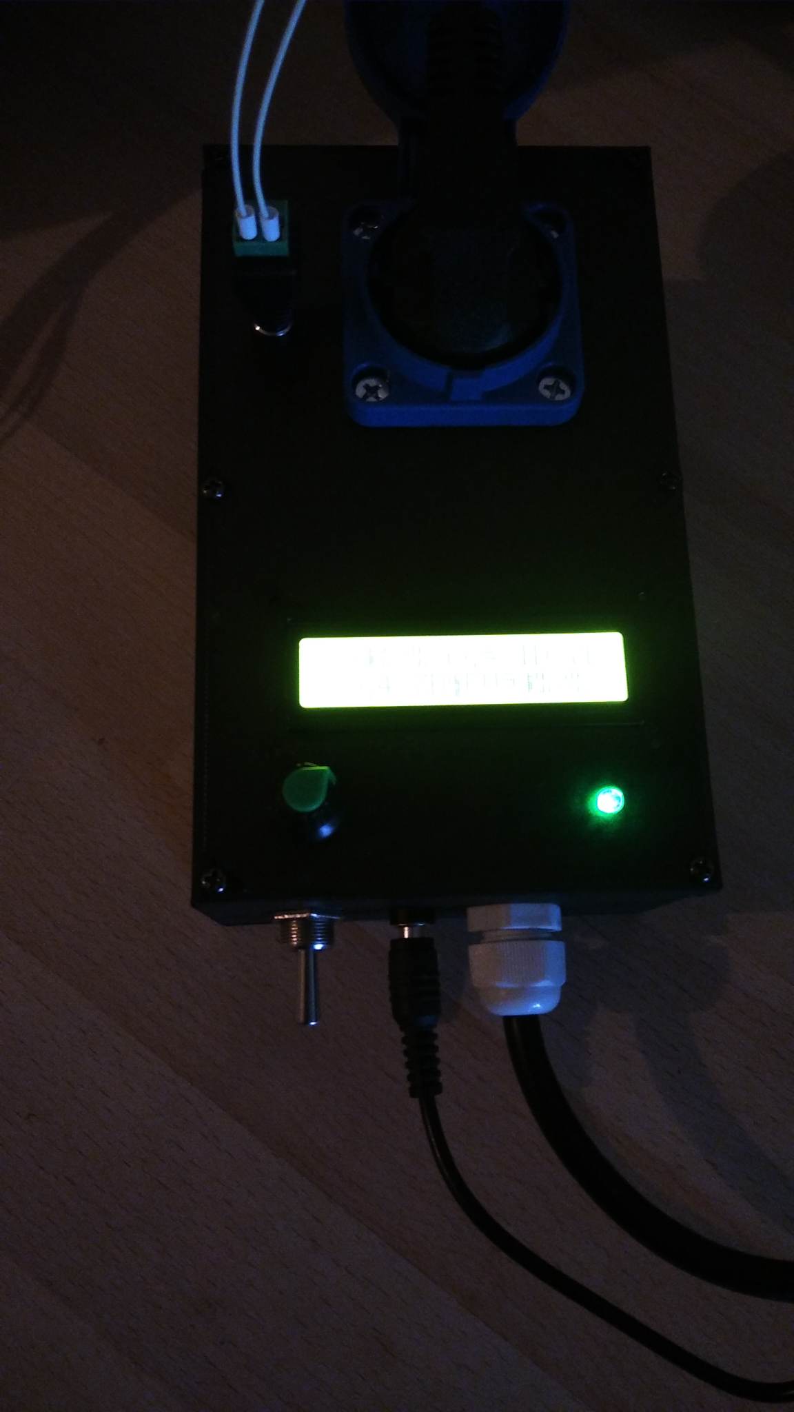

At first i was using a wall 5v phone charger to power the setup wich was placed inside the enclosure with all the other components, my thoughts were that there is some sort of EMI that corrupts the data sent to the screen, caused by electronics inside the SSR, mains voltage wires that goes to the socket wich pass near the 5v arduino wires, noise caused by the transformer of the psu, and the screen placed right on top of these.
I have changed the psu with the one mentioned before, that sits outside the enclosure and delivers power through a round plug from wich there are some short wires that goes to the arduino 5v pin, potentiometer, screen..
The problem still persists but it doesn't happen right away, only after a few seconds/minutes when it starts showing weird characters and even end up being blank.
The solders of the screen and the i2C adapter are all good, i have added a ~47uF cap on the wires that power all of the things mentioned above. Another thing is that when i have chosen the resistor for the thermistor voltage divider, with a smaller one i got more problems with the screen than with a bigger one 6.6kohm that is now on the circuit.
I have thought that there is to much consumption from the Arduino nano and it can't handle all the components some times the green led shows that the setup works fine even it the screen doesn't but sometimes it all freezes and adjusting the potentiometer does nothing, the led + relay remaining on and the screen messed up.
Lately i have tried to power through the usb port on the arduino from a laptop that delivers about 4.5V and i didn't got much problems so far, the screen is not that bright. So why would powering to the 5v of the Arduino cause problems with the screen?
Here is the code;

I would appreciate any help!
Regards, Alex!

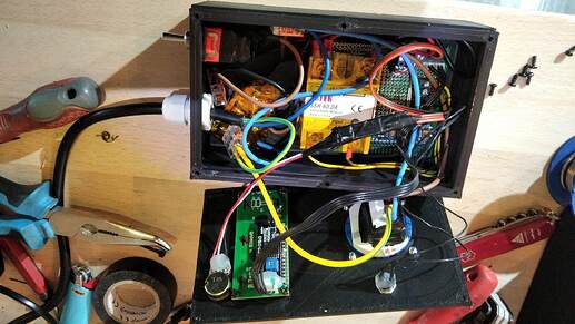

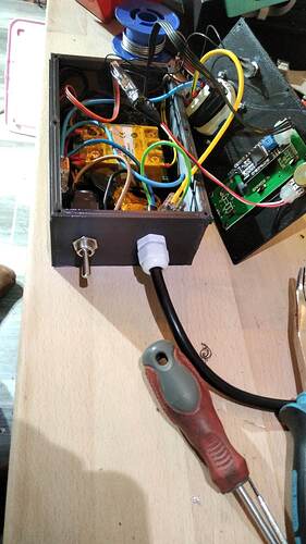

I forgot to post the inside of the box, i did now but it is messy and it's with the 5v phone charger placed inside instead of the external one but that doesn't make a big difference.
I haven't used breadboards, all connections are soldered to a prototyping board where are placed some screw connectors for all wires wich are also soldered directly at the other end or screwed using ferrules.
The only plug in connections are for the potentiometer and the screen wich have some JST / dupond type connectors from my 3d printer wires that i had lying around but they seem ok, if it works with power through laptop usb then is shouldn't be an issue
If it was to be the conection on the i2c module, scl sda gnd and + then i guess it shouldn't work with laptop either
Nice try on the schematic but it is not what you are showing in the pictures. Please show alll connections, power supply, grounds, etc. Posting links to the hardware items helps all of us if they show technical information. Links to amazon and other similar market places do not have the needed information.
The connections are not number one suspect. However, know that solder moves into the strains in multi strain cables. This makes that area woulnerable.
You have some stiff cables in the box... They might press on some connector and change things when the box is closed.
How do things run with the top off? Touching cables softly could show a weak point.
Intersting, i ran the setup with the box opened when i had the first phone charger psu thinking that the emi could be a problem and i have separated then a little to give some space. It still hapened but not so often from what i remember i could try again but i think it got tired of me opening and closing the lid :slightly_smiling_face:
Still the laptop vs wall psu doesn't influence the inside wiring or moving anything while testing so i am wondering what does powering trough 5v vs usb makes a difference ?
I suppose i can post links if they help but i have some pretty generic parts. What are you refering that is not the same in the drawing ?

The thing is that i have considered the ssr to make noise so i have tested with it off also but the screen still messed up after some time

Although i am printing on the screen within 1 sec intervals using lcd.setCursor(0,0); lcd.print("Set temp = "); wich just replaces the characters instead of wiping the whole screen with lcd.clear(); so that it won't take that much time to complete and overstress the screen. For this i will get double C C on temps that are 1 or 2 digits when i come from 300 C below and won't erase that C just replace the characters to it's left.
Ex something similar;
Set temp = 300 C
Set temp = 3 C C

Your LCD char set has Katagana RA and ME with a DAKUTEN which softens a palatial aspiration (k >> g).
I think i can try to adjust a usb cable to power with the wall psu trough it instead of 5v pin to see what happens. It s a soldering iron wich has an internal winding of wire so i think it s resistive load, adding a snubber (cap + resistor) migth help as pointed out but idk the values that i need
But also the problem happenes with no switching of the ssr that was powered off also.
The first charger might have a limit and the second psu is a cheap 5v 3A psu so it might cause problems..

Am i not sending corect bytes, is serial baud rate definition interfering or should i modify the i2c address? Sometimes i get a blank screen after a while of this weird one
Can you create a custom character of "all 1s" to see if a bit or line is held low or high, then a custom character of all zeroes, the an alternating one-zero, then alternating zero-one.
Also, there is a way to use an old ASCII character set, but that escapes me.
Something inside the LCD is overheating. Do a physical inspection.
That can actually be due to higher voltage of the psu. I have just tried to power also from the laptop usb but on the 5v pin of nano and it also works and it is brigther that via usb port on nano. It shouldn t heat after few seconds 10, 20 s maybe
