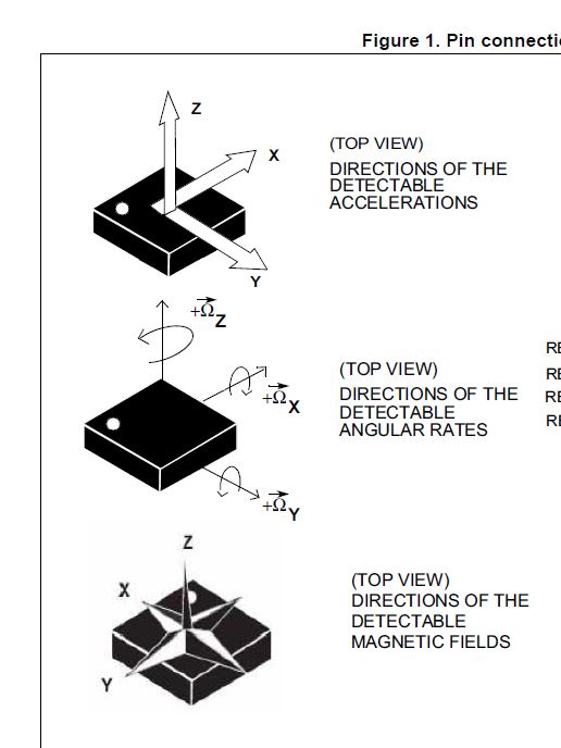

For any AHRS fusion filter to work, the gyro, magnetometer and the accelerometer have to use the same, right handed coordinate system, and be properly calibrated.
The manufacturer-assigned coordinate systems of the LSM9DS1 are inconsistent and need to be corrected.
After fixing that, I suggest to learn about better ways of calibrating the sensors. Working examples can be found at GitHub - jremington/LSM9DS1-AHRS: Mahony 3D fusion filter and tilt compensated compass, with sensor calibration code

FYI, from the LSM9DS1 data sheet. Note that the manufacturer-assigned accel/gyro axes form a left handed coordinate system.

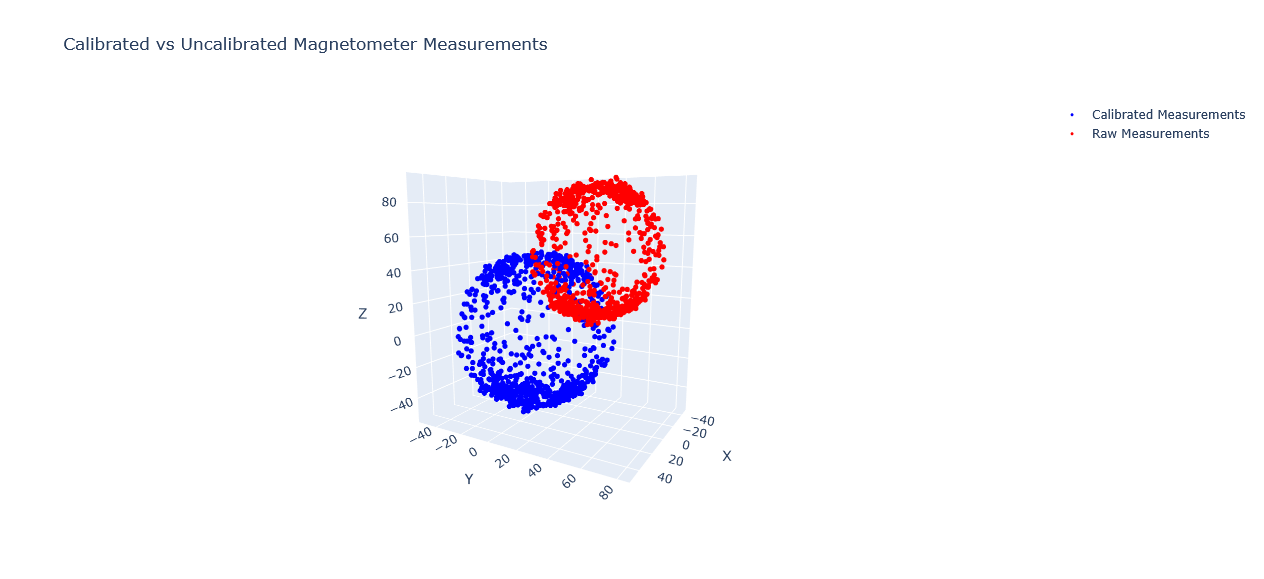

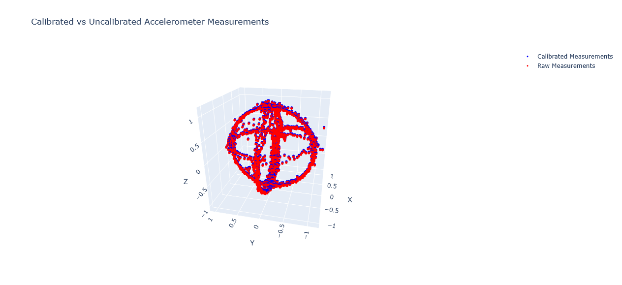

Hey jremington,
thanks for already helping me out with the Madgwick-Filter.
However, I'm simply not achieving the destined behavior.
That's why I decided to try out your implementation of the Mahony filter (https://github.com/jremington/LSM9DS1-AHRS/blob/main/Mahony_AHRS/MahonyUW_AHRS.ino). Here's my implementation:

Unfortunately, I'm getting absolute non-sense values.
I'm calibrating my accelerometer and magnetometer using magneto, just like you recommended. Here are two graphics displaying the calibration results.
According to this, I'd say that the problem is not due to lacking calibration.

The code is a bit difficult to follow, given the arbitrary renaming of so many variables, but nothing jumps out at me.
Check that the axial assignments for the magnetometer and accelerometer are correct by printing out the calibrated, normalized and corrected values for each axis, when that axis is aligned along the direction of maximum field strength.
The reaction force to gravity points straight up (positive), and the Earth's magnetic field points North and down in the northern hemisphere, North and up in the southern hemisphere. The value should be about 1.0 when the axis is properly aligned.
Remember that after flipping the acc/gyro X axes, the positive X direction will be opposite the direction indicated in the manufacturer's illustration (post #6).
For future people finding this thread via search engine, including me when I again forget how the axes are defined. :smiley:
Here is a nice reference on how the Nano 33 IMU axes relate to the NED (north-east-down) convention: Arduino Nano 33 BLE – AHRS – Axodyne Engineering
