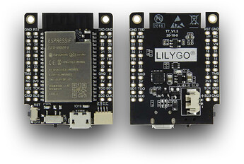

see my post (in French) for the LILYGO TTGO T7 V1.5 Mini32 ESP32

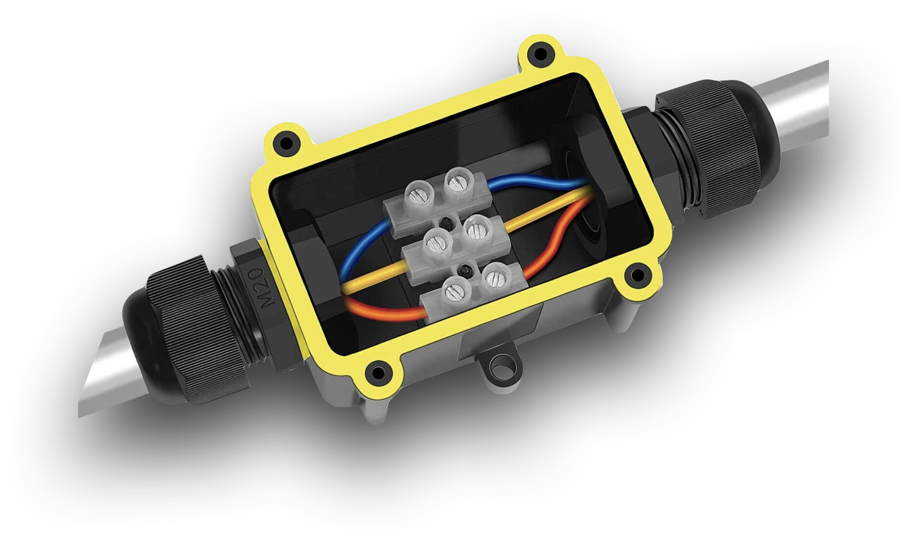

I got 84µA in deep sleep (I removed the on board red LED that was always on) and it's small enough to fit in one of those small water-resistant (IP68) outdoor electrical enclosure
and there is room for a 1000mAH battery (the sensors are outside, through the wires)
