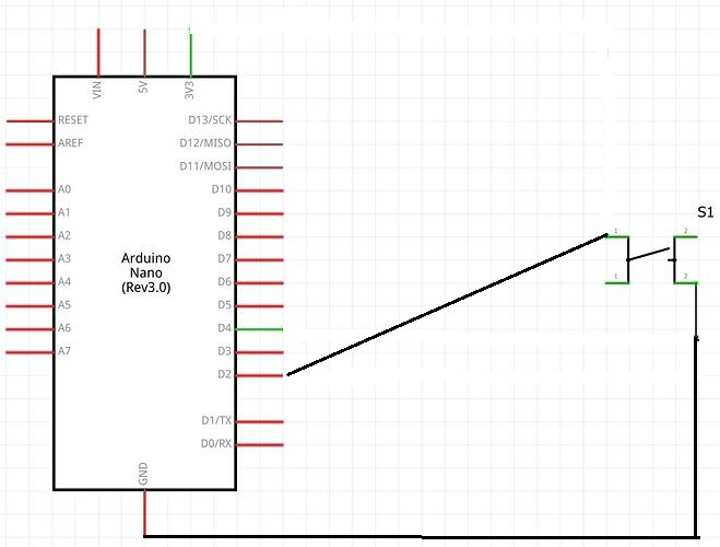

Hi!
This post caught my attention as I asked myself this same question recently because of a project where I use a PIR sensor to wake up an ESP32 CAM. I´ve found out that the ESP´s 3V3 rail keeps energized even while the board is sleeping.
I also have a Nano 33 IoT, so I decided to do some testing for future reference of others who find this post. After some experimenting, I´ve found out that:
  1. The 3.3V port of the Nano 33 IoT was also still alive during sleeping (measured with a DMM);
  2. I don´t know how to explain it, but in my Nano, PIN 4 didn´t work to wake up the board. I used PIN 2 instead.
I wouldn´t connect things as you did, because while the button is not pressed, the pin signal can assume any value (fluctuation). If you want to wake up the board by providing 3V3 to the pin, you should add a pull-down resistor to your circuit and make sure the pin reads zero while the button is not pressed.
But a better way to do it is setting the pin as INPUT_PULLUP and connecting your button from it to GND. So the pin will have the state HIGH until the button changes it to zero. No resistors needed.
You can test the code below. It will turn off the LED-BUILTIN after your 5 seconds delay. Then it will turn on the led when the button is pressed (connected to PIN 2 and GND).
//Test Deepsleep wakeup
#include "ArduinoLowPower.h"
  pinMode(LED_BUILTIN, OUTPUT);
  while (!Serial);
  Serial.println("before LED");
  pinMode(2, INPUT_PULLUP);
  Serial.println("going to deep sleep in 5s!");
  delay(5000);
  LowPower.attachInterruptWakeup(2, wakeup, CHANGE);
  LowPower.deepSleep();
void wakeup() {
This would be the connections:
