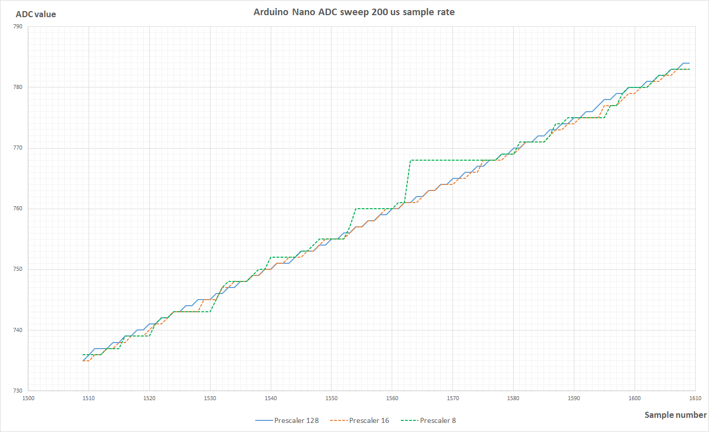

I made a test of my Arduino Nano PCB to evaluate how a change of the ADC prescaler influence the quantization error of the ADC. A prescaler value of 128, 16, and 8 was tested, which provide an ADC clock of 125 kHz, 1 MHz, and 2 MHz.
I made a program to control a sweep generator made by a rail to rail op-amp implementing an integrator as you see here:

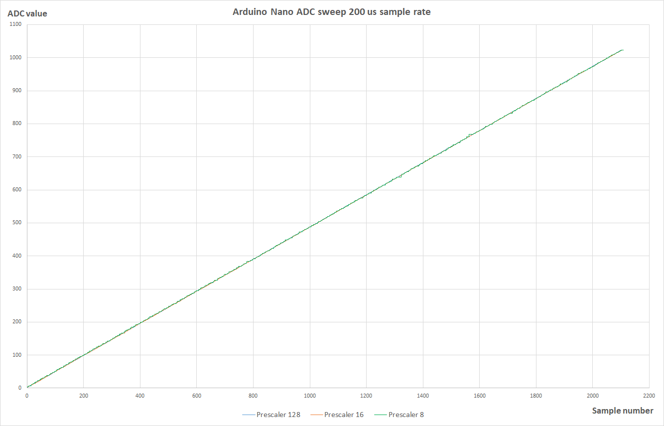

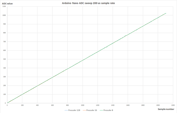

It samples 750 values with a sample rate of 5 kHz. Three sweeps of each prescaler valule was done to get 3x750 samples for a hole sweep. It makes 9 single runs in all to obtain the curves below. In this way you will ideally get at least two samples with the same ADC-value in the sweep.
This is the total sweep:
The curve below is the same data, when you zoom in some data. With the fast ADC clock, you have some ADC values, that the ADC "prefer" to deliver. Then it becomes unlikely that the ADC provide some neighbor values. It is easy to see with the prescaler at 8, but at prescaler at 16, you see a small tendency of the same problem.
I have previously seen recommendations, that you should be able to use a prescaler value of 16 with the classical Arduino without too much error, and I think this test confirms that statement. I have not seen test data, that could confirm what was going on. So I hope this data can help you.
If you have seen other test data of the ADC converter and other ways to test it, I should like to know about that.
How many times has this last diagram repeated itself?
You will of cause not find an exact repetition. I think I zoomed at one of the worst cases in order to provide some understanding of the behavior. There is of cause also a bit of normal noise here.

As far as I can evaluate this, it is not ordinary noise, that is the main problem with higher ADC clock. It is the quantization error. One way for me to confirm this would be, to repeat the sweep with the prescaler at 8 some times and zoom at the same part of the curve. Then you should see the same kind of quantization errors occur again. In this way you can rule out normal noise. What do you think about that?
Are there some parts of these data, that you find hard to believe as being true?
Not likely. It's to much. One uncertainty is the mains supplying the 5 volt converter. The long leads to/from the resistors. That setup is not suitable for low noise, precision measurments as I see it.

I am not that familiar with AD-converters, but I guess that the behavior I show would be normal for a successive approximation AD-converter, when you start to clock it faster than specified. You have got a critical comparator in the circuit, and it have a hard time to settle in time when some of the more significant bits change. You see that the value stuck at 768, and it is binary 1100000000. So just after the second most important bit had changed, it seems to influence the stability for the lower bits.
I just measured the values three times with the 2 MHz ADC clock, and you see the result here:
I think you find the same behavior in all three sweeps.
I like to have some faster conversation in an application of some accurate low speed control of an DC motor. The tests confirms for me, that an ADC clock of 1 MHz should be OK for me to use, but 2 MHz starts to show too high errors.

Quantization error for a given ADC is fixed, it is not dependent on sample rate.
Not sure what your measurements show but it is not related to quantization error.

The good thing the data show is, that the ADC works quite well under normal conditions up to an eight time higher conversion frequency with a ADC clock of 1 MHz. I would think that you lost about ½ to 1 bit in accuracy. At 2 MHz, you get at significant decrease, and at some conversion values you lost 3 bit in accuracy. I think this is significant information for a user, that wants shorter ADC conversion time.

ADC clock is not used to control sample rate. ADC clock is used internally by the ADC for the successive conversion process. According to datasheet the full process of sample hold and conversion takes 13½ clock cycles.
The sample rate is controlled by the software, and I start a conversion each 200 us (5 kHz) based on a busy-wait reading the micros() function. So the sample rate was the same for all the tests I did.
The quantization error is the difference between the provided ADC value (converted to voltage) and the exact analog voltage that the ADC measures without noise. When you start to increase the ADC clock, you introduce increased quantization error above the normal rounding that an ADC do. Do you have a better name for this error?
https://www.sciencedirect.com/topics/engineering/quantization-error
Unfortunately your data only applies to your particular 328P. Since you are running tests outside of the recommended operating parameters, there is no reason to assume that your data applies to all 328Ps manufactured. For your data to have any statistical significance you would have to run your tests on at least 100 different parts.
Quantization error for a given ADC is fixed, it is not dependent on sample rate or clock frequency.
The errors you are seeing are of an unknown origin, however, quantization will be part of the error but it is not the total reason for the errors you see.
